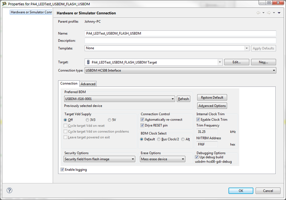

I have installed this version of USBDM on my computer but I cannot get it to work with the PA4, programing via the Codewarrior (10.4) sometimes work / sometimes not (then  I have to cycle power to the PA4).

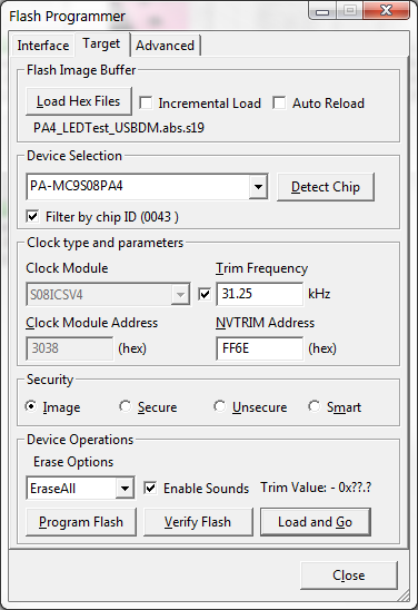

Through the HCS08 Programmer utility the chip can't be verified after programing and the error shown on the picture below occurs (readback of the flash contents does not agree with buffer).
I have noticed that I can't change the NVTRIM value when I check the trim frequency checkbox, on my test firmware I have pointed the NVTRIM @ 0xFF6F (thats the correct value right?) but on the HCS08 Programmer the value is always fixed at 0xFF6E. On the Codewarrior Run Debug settings / USBDM configuration the value appears correctly when I enable the Clock Trim Configuration

Problem solved returning the old version of the USBDM (4.10.6.110), the current version of the USBDM (4.10.6.120) has problems with the PA4 answer by the pgo itself on this topic USBDM - Version 4.10.6.120 (RS08/HCS08/HCS12/CFV1/Kinetis BDM)
