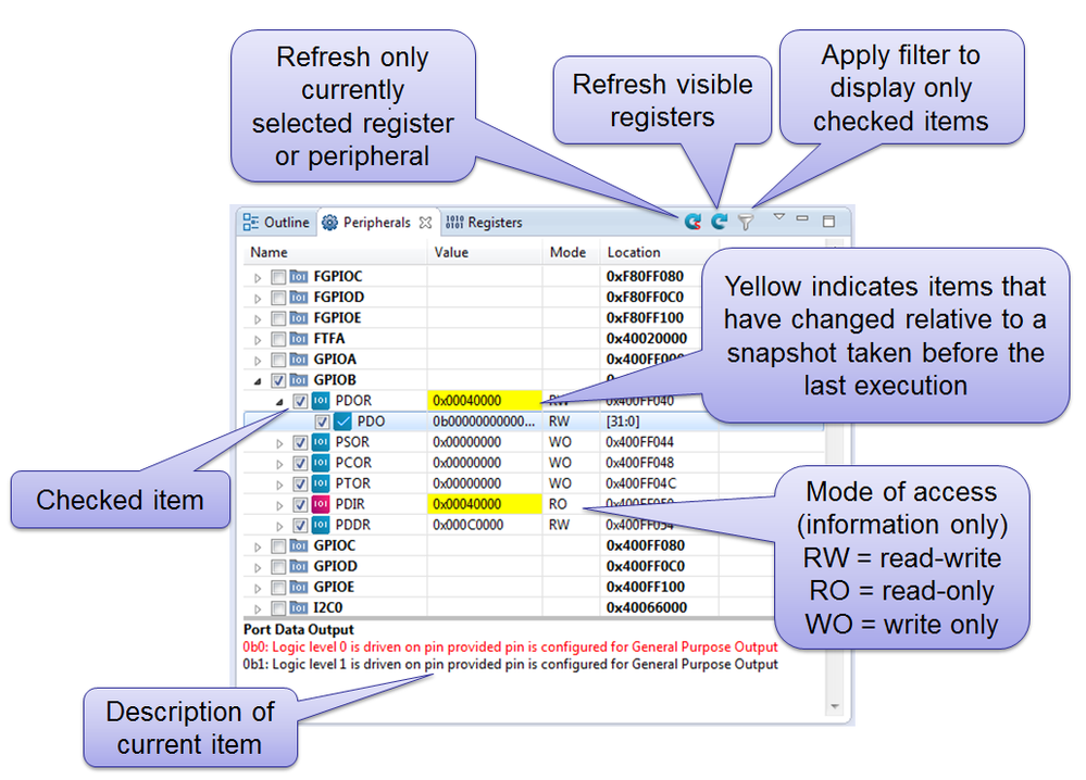

   New features in Eclipse
   - Added Peripheral View (Kinetis devices)
   - Added SVD files and derived header files
   - Added CMSIS-RTX support (Kinetis devices)

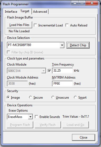

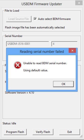

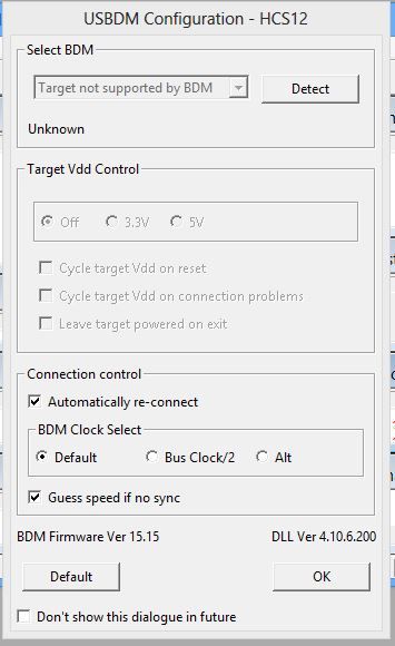

zhanjiancheng
6,594 Views
pgo
Senior Contributor V
Hi Jiancheng,
It's unclear if you succeeded in updating the flash image - the Failed to erase message is a bit worrying.
You appear to using Windows 8.  USBDM has not been tested with Win-8 so it is possible that there is some problem associated with this.
I would suggest trying the firmware update an another machine and confirm it it behaves differently.
bye

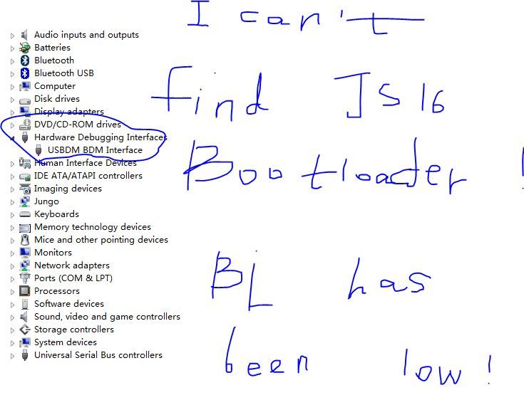

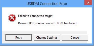

zhanjiancheng
Hi pgo,
    I'm try to make a js16 usbdm. But when I try to start the
Update of BDM firmware
, I find that the version is wrong and the device doesn't show as you say. I don't know what to do now.
6,594 Views

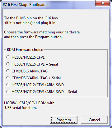

pgo
Hi Jiancheng,
Please don't post at the end of an old thread.
If you are programming a device for the first time or want to entirely erase a device from scratch you tie BL low as you have done but you then use the JS16 First Level Bootloader as shown.  This was provided to replace the Freescale one which no longer works.
Make sure you choose the correct firmware version to suit the hardware:
The bootloader you are using is for later updates without the need to use BL.
Please see the following page for detailed instructons:
USBDM: BDM Construction and Firmware
bye

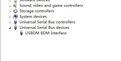

zhanjiancheng
thanks for your answer. i have try that and i finally found the js16 bootloader device,then i get the device looked like below. but i still can not use it or update it.

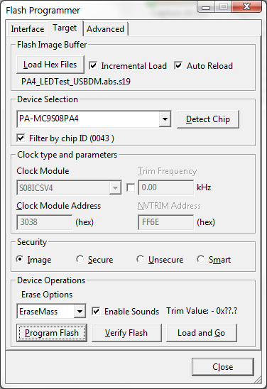

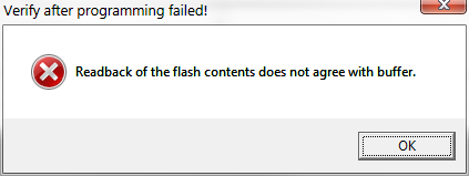

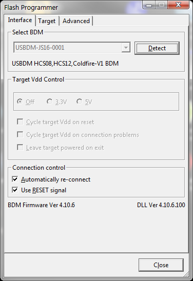

JohnnyS2K
Hi pgo,
Thank you for this new version of the USBDM!
I have installed this version of USBDM on my computer but I cannot get it to work with the PA4, programing via the Codewarrior (10.4) sometimes work / sometimes not (then  I have to cycle power to the PA4).
Through the HCS08 Programmer utility the chip can't be verified and occurs the error shown on the picture below (readback of the flash contents does not agree with buffer).
I have noticed that I can't change the NVTRIM value when I check the trim frequency checkbox, on my test firmware I have pointed the NVTRIM @ 0xFF6F (thats the correct value right?) but on the HCS08 Programmer the value is always fixed at 0xFF6E
Thanks!
Captura de tela 2014-03-12 21.06.39.pngCaptura de tela 2014-03-12 21.08.21.pngCaptura de tela 2014-03-12 21.07.54.png
6,594 Views
pgo
Hi Johnny,
Yes I seem to have broken something on the PA4 in the latest version.  I made some changes for SF4 and it would appear to have broken PA4.
Please re-install that previous version until I have a chance to fix it.
bye

JohnnyS2K
Hi pgo,
Now it worked again!
Thank you!

pgo
Hi Johnny,
I believe the 0xFF6E value is correct.
The ICS clock used in the PA4 has 9-bits of trim.  This uses two memory locations - 0xFF6E-0xFF6F.  The value in the programmer dialogue is the address of the first of these.
If you change this to FF6F then one byte of the trim value will be written to the NV_BACKKEY0 location.
The example code give in the programmer manual is consistent with the suggested layout.
0xFF6E = FTRIM value (may be combined with other settings for the register containing FTRIM.
0xFF6F = NVTRIM value
The PA4 Reference manual doesn't give suggested address locations for the trim bits in Flash.  Other devices have done so and this layout is based upon those.
The labelling on the programmer dialogue is misleading since it refers to the later (better known) name.
bye
