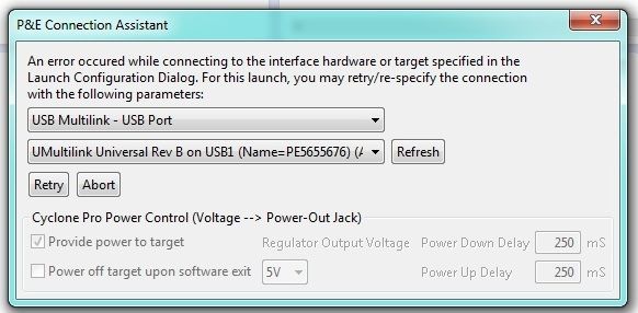

Hi everybody,
I'm trying to program/debug/erase a Freescale MC12311 transceiver IC (which has an HCS08 MCU embedded in it) via the 6-pin BDM header, using a P&E USB Multilink Universal, and CodeWarrior 10.4 IDE, on Win7 64-bit platform. The following "power cycle" error occurs when I try to program/debug/ease the target IC:
But unfortunately, turning off/on the power doesn't help, and it fails to connect to the target.
The following picture is the schematic of my circuit, in which the red circles depict the BDM header and connections:
The following is a list of the related issues I've tried:
  1. I've added 10k pull-up resistors to both BKGD and RESET lines; but no success! The same error occurs and it fails to connect to the target.
  2. I try to turn off/on using either the main power supply, power jumpers, reset switch, etc.; but it doesn't matter; again no success!
  3. I checked the pins on the pcb, and everything seems OK. I mean, it seems that it has been soldered without any significant problems.
  4. I monitored both BKGD and RESET pins: some activities (going from low to high, and high to low) are monitored after I press the "erase" button on CodeWarrior IDE.
  5. I tried to monitor the external 32 kHz and 32 MHz crystal resonators, using a 10x probe, with both an analog oscillator and a digital counter. However, no activity is observed, nothing at all! It seems that either the crystals or the respective internal circuits are dead!
  6. The datasheet mentions that "the MCU has an internal crystal oscillator, which is enabled in every power-on-reset, without need for external components". What I understand from this part, is that the program/debug/erase step should be done without need for external crystals. This could mean that even if both of the external crystals are dead, I should theoretically be able to erase the MCU with the help of the internal oscillator. But I don't understand why it fails!
  7. I tried to program/debug/erase this IC using another version of CodeWarrior, such as 6.3, and also on another operating system, such as Win XP, or Win7 32-bit. But again no success!! The same error occurs, and it fails to connect to the target.
  8. There's another circuit board which uses the same MC12311 IC with almost the same components, configurations, and schematic. I tried all the mentioned steps on that board. But unfortunately, no success again! The same errors and the same failures!
  9. I checked the power: I provide 5-6 volt external power supply; it passes through a 3v3 regulator; then it passes through a schottky diode, and the final regulated 3.1 volt powers the IC. It is mentioned in the datasheet that the accepted input voltage range is approximately 2.5 ~ 3.7. So I don't think this "3.1 volt" would cause any problems.
I really don't know what to do next to solve this challenging problem!
What should I do? I would be really grateful if you give any helpful comments or replies.

Actually, I tried the power-cycle action in different ways:
Powering off/on only the MCU power, the 3v3 regulators, the whole board's power, etc. But no success !!
Also, I've checked this on different computers, either laptop or pc, and also on different OSs; but the same errors occur !! :smileyconfused:

I zoomed in to the picture you referred, which is as the following:
It seems that after 6 cycles of some initial commands on BKGD, three events occur: (1) the BKGD pin goes to low, then (2) a reset occurs on RESET pin (which is very short, perhaps a few micro-seconds, as you illustrated before), and then after the release of the RESET, (3) the BKGD pin goes to high.
So I assume that the P&E USB Multilink Universal programmer is working properly. Am I right?
Any other suggestions? What should I do now? :smileyconfused:

After a few seconds, the CodeWarrior gives the following error:
If I press "Retry", the same procedure happens again: the BKGD pin goes "Low", and the "power-cycle" error occurs!
