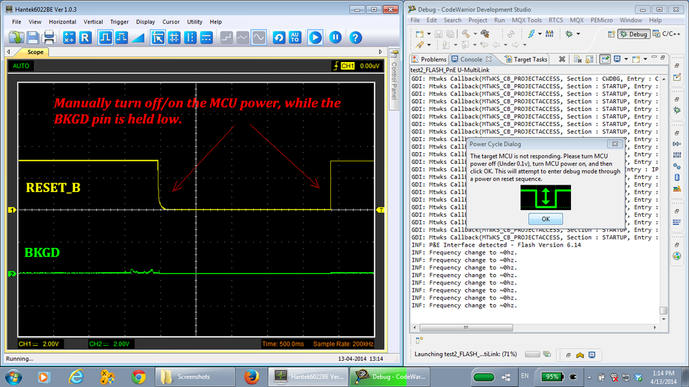

Hi everybody,
Today, I monitored both the BKGD and RESET pins on a digital oscilloscope. The following pictures illustrate the scenario:
(Note: The BKGD in the first picture is initially low, because of its state from the last debug session. In normal start ups, it is initially high.)
I would be grateful if you help me find out what the problem is, and what I should do to solve it.
Thank you very much.
10,364 Views
pavel_sadek
Hi Vahid,
your device has BKGD pin tied to high level once exitting the reset, it needs to be low .
AN2497: In the reset method, the RESET pin is released after the BKGD and RESET pins are pulled low, and then the BKGD pin is released.
Well in all cases you need to go through the Power on Cycle.
I did empty project with MC12311 in CW10.5 and my multilink was updated automatically  to version 6.14 (same as yours)
Then I have attached 1231x-MRB board to BDM pod and programmed the board without any issues
Then I stopped the debug of this empty project and went to flash programmer to trigger your condition
I took the option of flash file to target and did the Erase whole device
This erases the device and makes a blank check…
fl::target -lc "LC for Simple Flash"
fl::target -b 0x80 0x400
fl::target -v off -l off
cmdwin::fl::device -d "MC13211_FLASH" -o "16kx16x1" -a 0xc000 0xffff
cmdwin::fl::erase all
Beginning Operation ...
Performing target initialization ...
Device MC13211_FLASH
Detect frequence ...
Frequence 4397.21 Khz
Erasing .............
Erase Command Succeeded.
cmdwin::fl::blankcheck all
Flash Operation.
Blank Checking .............
BlankCheck Command Succeeded.
Then I did a POR and pressed the debug icon – this generates the expected result
Now I do the power cycle as I am prompted to
And communication begins correctly, on the reset you would see drop down to low for ca 10us (green) meanwhile the BKGD pin is low(yellow), the same should be visible, if you do the reset from the Codewarrior
If single power cycle does not help, do another one or start the debugger and apply the voltage after that.
So give it a try with my project, once the device is programmed, you should not observe the failing condition.
Pavel

vahidelc86
Thank you very much PSA for your great help. That's nice of you. I do really really appreciate it.
Regarding your suggestions:
1. your device has BKGD pin tied to high level once exitting the reset, it needs to be low .
Actually, as illustrated in the following picture, the BKGD is held low, while power cycling the device. Please correct me if I'm wrong. Did you mean something else?
2. So give it a try with my project, once the device is programmed, you should not observe the failing condition.

pavel_sadek
I was referring to the picture from 1:22pm
in fact you shoud see two cycles of reset, one - long during the manual power disconnection, this is real power on reset
another reset should be created by the multilink (pin reset only), its timing is some 10us on my screen and the state of BKGD pin after this one is importatnt for you. As stated in AN2497 it needs to release reset first and then bkgd to high to get into BDM.
you can force the device to BDM after first reset (POR) by holding BKGD pin low. Most likely the device was in BDM state once Reset went up on your screen. But it was interrupted by multilink as it tried to connect the device by forcing it to bdm its way using the RESET.
The issue here is that multilink is not a production programmer and has no capability to control power to the target. that is why you need to go through this excercise... once the device is in BDM and programmed or unsecured, you should not experience such a problem on this device anymore...
Pavel
10,363 Views
vahidelc86
Thanks again dear PSA for your great support.
I zoomed in to the picture you referred, which is as the following:
It seems that after 6 cycles of some initial commands on BKGD, three events occur: (1) the BKGD pin goes to low, then (2) a reset occurs on RESET pin (which is very short, perhaps a few micro-seconds, as you illustrated before), and then after the release of the RESET, (3) the BKGD pin goes to high.
So I assume that the P&E USB Multilink Universal programmer is working properly. Am I right?
Any other suggestions? What should I do now? :smileyconfused:

vahidelc86
Thank you very much alistairmuir for your reply. I do really appreciate it.
First, let me say that both BKGD and RESET pins have external pull-up resistors (10k and 15k, respectively).
The RESET pin has also a decoupling (pull-down) capacitor too (1000 pF).
Both of these pins are connected only to 6-pin BDM header and the IC itself, and nowhere else.
For the exact states of the BKGD and RESET pins, I should probably use a digital oscilloscope to monitor the toggling of their states. But for now:
Both the BKGD and RESET pins are "High" after POR (probably due to their pull-up resistors).
However, after I press the debug/erase button at CodeWarrior, the BKGD pin goes "Low", and the "power-cycle" dialog appears.
I turn off/on the MCU, as the "power-cycle" dialog suggests, and press OK; then the BKGD pin goes "High" again.
After a few seconds, the CodeWarrior gives the following error:
If I press "Retry", the same procedure happens again: the BKGD pin goes "Low", and the "power-cycle" error occurs!
During all these procedures, the CodeWarrior logger console writes the following logs:
Frequency change to ~0hz.
Error: Can not enter background mode .
I guess the problem could be related to the internal clock generator (ICG) of the MCU. How should I know if it's working properly?
I hope somebody helps me find the solution to this challenging problem. :smileysad:
