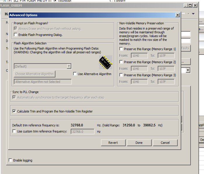

As for my questions: "The "Factory programmed" values are now loaded automatically on boot by some internal processor magic. I checked these values against the programmed trim values and they are significantly different, the factory value is 0x0801 and the above is 0x0861. They are they so far off each other?"
I guess what I am saying is if i boot the processor and inspect the timming values, I see 0x80(TRIM) and 0x01 (FTRIM) loaded automatically by the processor. When I use the programmed values at 0xFFAE/F I get 0x86 (TRIM) and 0x01 (FRTIM). Why is the internally set TRIM so far difference from the programmed TRIM?

vicentegomez
Hi Carl
Are you using CodeWarrior? in it there is a Advance option and probably the trim value is not the default value.
