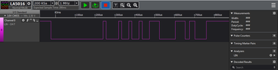

I use mc9s08dz96. I wrote the corresponding registers to create a break at the beginning of the data LIN frame. The data frame is sent correctly, but the problem is that the break part is not 13 bits. I set the break registers like this:

I initialized these registers:

 BRK13 defines for us that the break length is 13. If you have noticed in the registers above, I have set it.
setReg8(SCI1S2, 0x04U);
 Finally, the frame LIN is like this:
Break is correctly sent, also 0x55, 0x34 for sync and ID, respectively. But the break length is not 13 bits. what is the reason?
