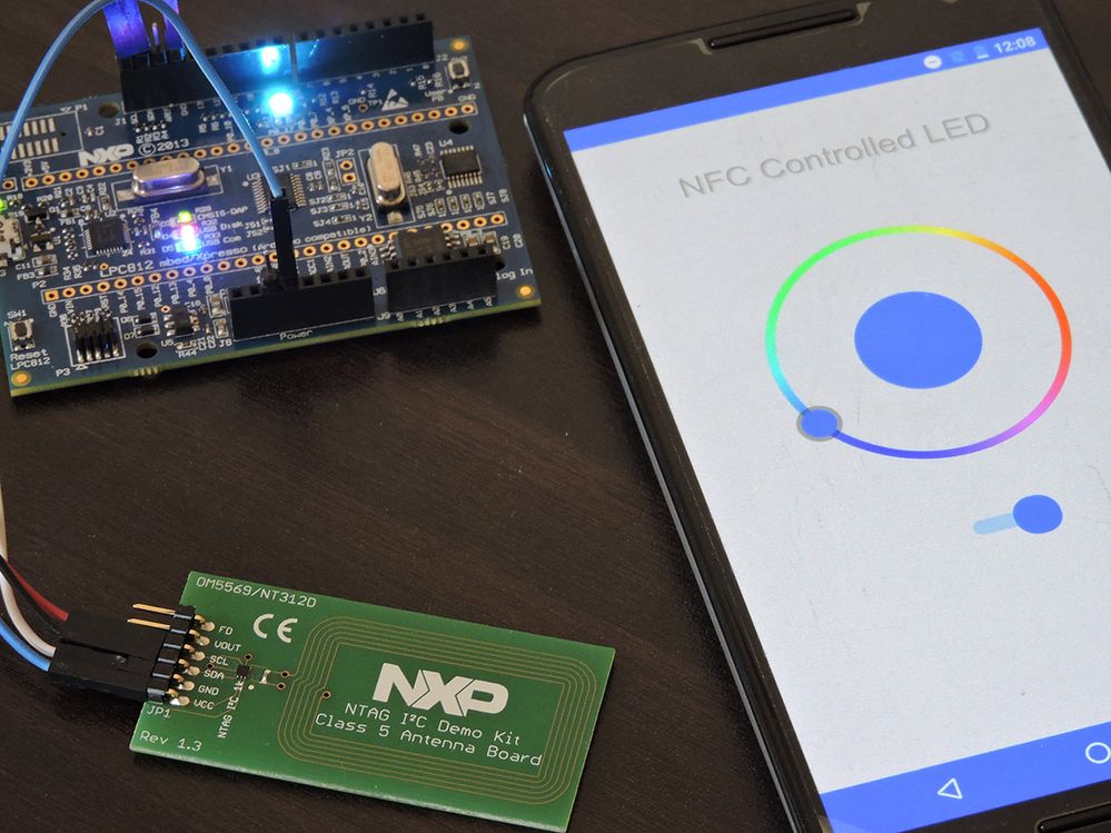

This project demonstrate the controlling of RGB led over NFC by smartphone. LPC812 MAX board is interfaced with NTAG I2C board (NT3H1101).

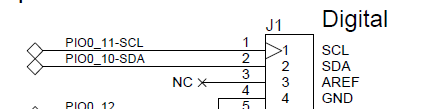

The pin connections are here,
P0_11 -> SCL_NTAG
P0_10 -> SDA_NTAG
P0_7 -> RED LED
P0_17 -> GREEN LED
P0_16 -> BLUE LED
The NTAG is having 476 pages with 4bytes per each page. For this project we used the page1 (4bytes)
byte1 - Led status (On/Off)
byte2 -  Red value
byte3 - Green Value
byte4 - Blue
using of the android application , we can choose the color and corresponding RGB values  will be write into NTAG memory page1 by tapping the smartphone in it. LPC812 is loaded with wo tasks , the 1st one to generate the PWM signal (bit banging) based on the time_buffers, the other one is to read the NTAG Page1 values and update the time_buffers.
Here with i have attached the source code , and soon the Android application is available in Google Play here.
the working Demo here  https://youtu.be/tWfwOi7I0vk
