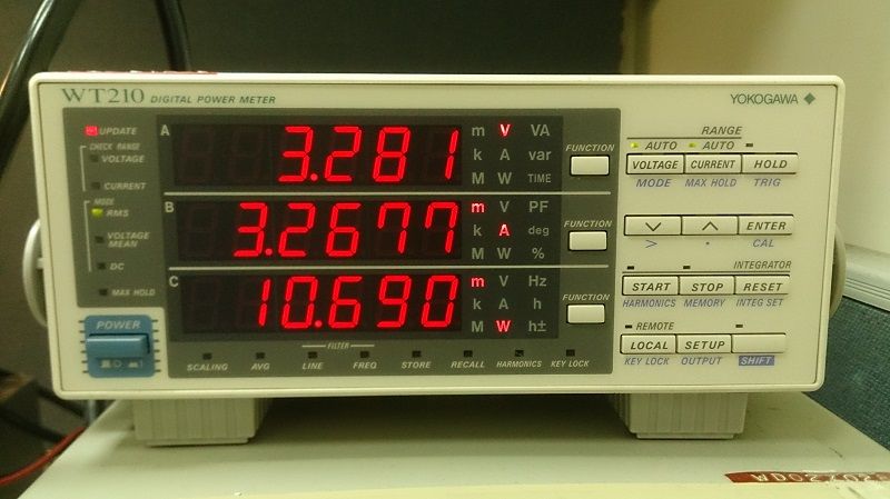

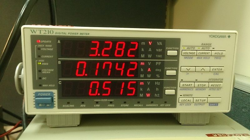

Run Mode
STOP3 mode

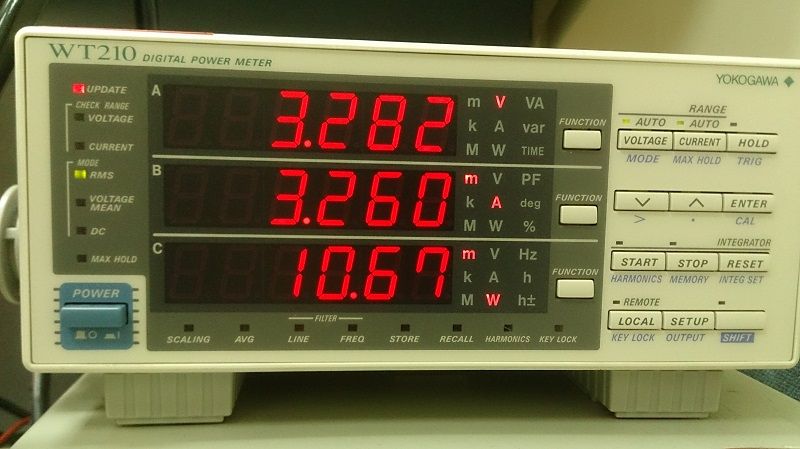

If I set  MC9S08PA4 into wait mode, it can work.
But I use KBI to trigger interrupt back to Run are fail, still in wait mode.

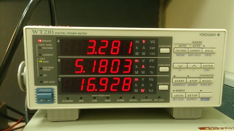

Wait mode
When KBI even happen
