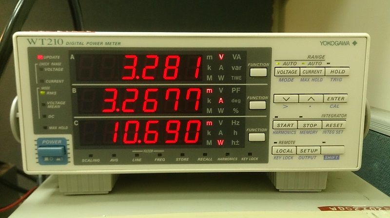

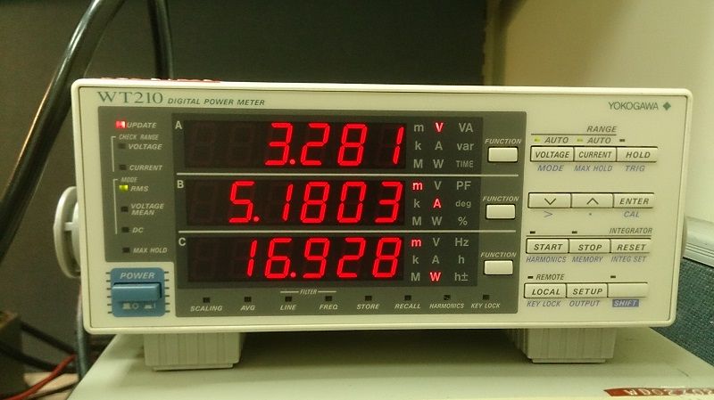

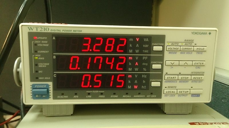

I have try to set MC9S08PA4 into STOP mode, and it can work, and use KBI to trigger interrupt to return RUN mode are work normal.
Run Mode
STOP3 mode

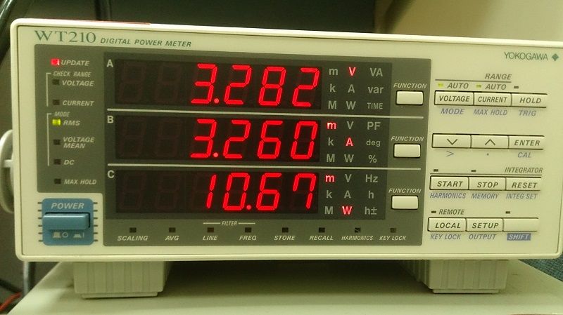

If I set  MC9S08PA4 into wait mode, it can work.
But I use KBI to trigger interrupt back to Run are fail, still in wait mode.
Wait mode
When KBI even happen
Is there something I have missed at wait mode?
