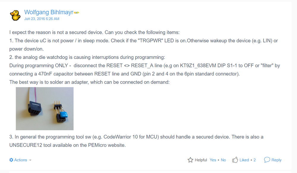

I do following on previous post as link below. the failure is gone. So for my conclusion of this failure.
we need to add a capacitor 470uF connect between #RESET (pin 2) and GND (Pin 4) for protect the analog die watchdog issue.

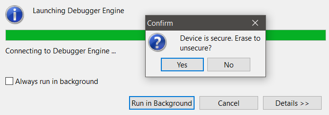

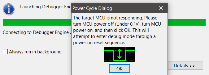

We found the device can't erase due to device is secure and we click "yes" the software has show figure 2 and then we did follow the message show, the figure 1 is repeating and we re-do again. the result has show on figure 3. how are we gonna fix for this failure?

Did you perform a power cycle? you need to unplug the device and the multilink that plug again and retry.
I hope this will help you

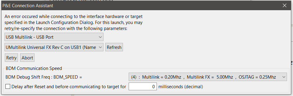

chitsanupong_ng
Yes, we did either multilink and the device the message still failed as picture below.pastedImage_2.png
