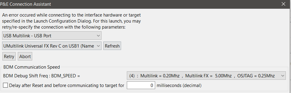

chitsanupong_ng
We found the device can't erase due to device is secure and we click "yes" the software has show figure 2 and then we did follow the message show, the figure 1 is repeating and we re-do again. the result has show on figure 3. how are we gonna fix for this failure?

vicentegomez
Did you perform a power cycle? you need to unplug the device and the multilink that plug again and retry.

chitsanupong_ng
Yes, we did either multilink and the device the message still failed as picture below.pastedImage_2.png

chitsanupong_ng
I do following on previous post as link below. the failure is gone. So for my conclusion of this failure.
we need to add a capacitor 470uF connect between #RESET (pin 2) and GND (Pin 4) for protect the analog die watchdog issue.
