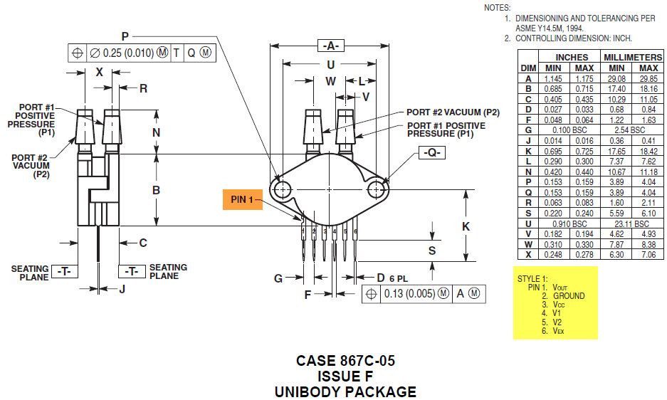

Hi,i want to use the pressure sensor MPX5010DP OR MOXV5010DP to monitor the pressure at which a crack develop on the application of the pressure.How do i connect the sensor?

Hello Peter,
In terms of electrical connections for the MPX5010DP, you may refer to the following figure, especially at the pin style:
In terms of Mounting Techniques, you may refer to the following application note:
AN936 - Mounting Techniques, lead forming, and testing of the MPX Series Pressure sensors
Besides, you may refer to the following application note in order to get more information about soldering recommendations:
AN3150 - Soldering Recommendations for pressure sensor devices
I hope this information will be useful for you.
If I misunderstood your question, feel free to let me know.  I will be glad to help.
Have a great day.
David Diaz.

peterugboji
Hi David Diaz,Thanks for your mail,is there anyway you can send me a picture or a Video on how the connection is made please.Thanks.

david_diaz
Hello Peter,
Please accept my apologies if my first answer was not clear.
You may refer to the following post in order to get more information about connecting the MPX5010DP device:
Different pin styles in pressure sensors documentation. Part 2
Please let me know if, despite this recommendation, you still need more detailed information.
