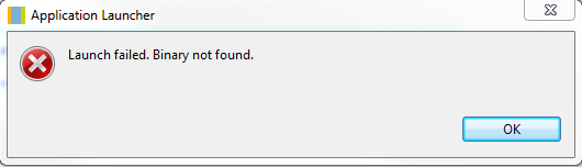

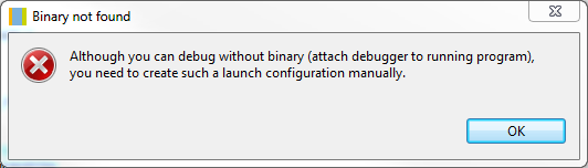

I would like to run the DimmableLight and the DimmerSwitch example but both gave me back an error.
2018-01-16 07_53_36-C_C++ - JN-AN-1189-ZigBee-HA-Demo_ColorDimmableLight_Source_App_ColorDimmableLig.png
It seems like the ColorDimmableLight example is the only one working. I loaded it on a Carrier Board for testing, but I didn't get the Debugger running. I always get this two messages:
2018-01-16 08_14_14-C_C++ - JN-AN-1189-ZigBee-HA-Demo_ColorDimmableLight_Source_App_ColorDimmableLig.png
First I made sure that the .bin file is in the ColorDimmableLight Build folder.
In the BeyondStudio Installation and User Guide(JN-UG-3098) I read that you can download the binary file via USB, but the debugging happens via JTAG.
The Evaluation Kit doesn't include any adapter, so how can I debug an application?
Jerome

mario_castaneda
Hi Jerome,
You have to edit all the OS Config Diagrams oscfgdiag files.
App_ZHA_Switch_JN516x.oscfgdiag
App_ZHA_Switch_JN516x_NFC.oscfgdiag
Mario

mario_castaneda
Hi Jerome,
I compiled the DimmableLight - GP example. successfully, what is the version that you are working on?
I downloaded the JN-AN-1189 (v1.15), this AN doesn't need any change, Are you working with the JN-AN-1221, aren't you?
Please take a look at JN516x JTAG Debugging in BeyondStudio
https://www.nxp.com/docs/en/application-note/JN-AN-1203.pdf
Hardware Requirements.
  • NXP DR1222 JTAG Expansion Board (see section 9 for schematics)
  • JTAG adaptor/dongle (Beyond Debug Key, or Amontec JTAGkey or JTAGkey2)
Mario
