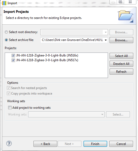

I have some trouble with the JN-AN-1218. this application node won't open in beyond studio for NXP. I have followed the steps from JN-UG-3101 and I see the project in the project explorer, but the resource does not exist.
product: JN5168-001-M00
IDE: Beyond studio for NXP JN-SW-4141
installed SDK : JN-SW-4170
problematic application node: JN-AN-1218

dirk_van_grunsv
I saved the Aplication Node in C:\NXP\bstudio_nxp\workspafe following the BeyondStudio for NXP installation and User Guide (JN-UG-3098)
first I imported the project(JN-AN-1218)

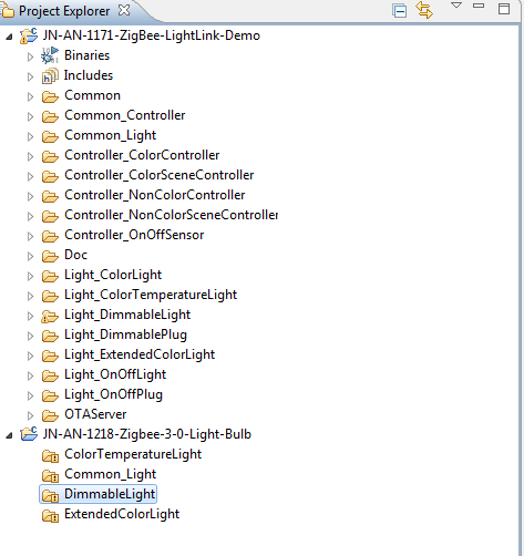

than it should be visable in the project explorer
I get all these yellow ! and I can't open the files. I followed the same path with the JN-AN-1171 and this works just fine.
Do you know what may be cousing the problem? I installed the right SDK for ZigBee 3.0 (JN-SW-4170) before this process.

mario_castaneda
Hi Dirk,
Please look at the https://community.nxp.com/docs/DOC-340028
You should not select the option JN517X, it is not supported by Beyond Studio IDE
