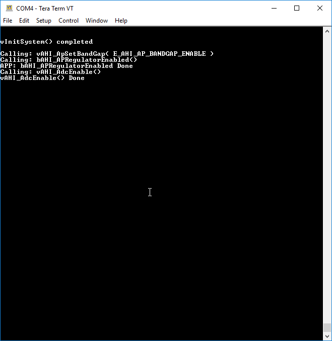

mferrari1
Hi Mario –
Please see the attached screenshot.
As expected, the third board behaved exactly the same as the prior two boards.
Once I call vAHI_ApSetBandGap() it never returns.
Just to be sure it just wasn’t a message display problem, I put a “Success” message after the call to the function, then entered a while( 1 ); loop (yes, the Watchdog is disabled).
This problem has remained unresolved for a long time now and is beginning to threaten the release date for this project.
Perhaps you can escalate this issue within NXP?
I have suggested several times to have NXP look at the source code for this function and let us know what will cause the function to not return, but as far as I can tell, that hasn’t happened yet.
Knowing what will cause this function to not return should point us to the source of the problem. Can you please find out about that?
Since this is a Jennic/NXP API, I don’t have access to the source code. It’s an NXP Black Box that I call and never return from.
I don’t know what more I can do. Please advise.
Matt

mferrari1
Hi Mario –
I have solved the mystery about the failure of the vAHI_ApSetBandGap() function failure to return.
This function should not be called when using the ADC2 Pin as an ADC input signal.
Whereas all the example code calls this function, whereas the code you sent me calls this function and whereas the function name itself suggests that this function is used to select the Internal Band Gap Reference as the Reference for the ADC, the truth is that this function actually routes the internal reference out to the ADC2 pin so that it can be externally bypassed if so desired.
Calling vAHI_ApSetBandGap() when an external signal is being applied to the ADC2 Input will cause VREF to fail, as VREF will now be shorted to the signal being externally applied to ADC2.
So the correct answer is: “Don’t call vAHI_ApSetBandGap() when ADC2 is being used to measure an Analog Input signal”.
Matt

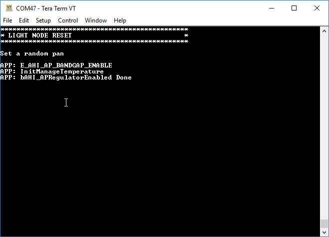

mario_castaneda
Hi Matt.
I am checking by my side.
Is the device in sleep mode? Is this issue happen when you are not debugging?
I ran some test, I did work with the JN-AN-1218. Could you please try to flash the DimmableLight example. I want to confirm the JN is not damage.
PUBLIC void APP_vManageTemperatureInit(void)
    /* set up the ADCS on platforms that dont already use them */
    /* Set up the analogue peripherals ready to handle the conversions */
    vAHI_ApConfigure(E_AHI_AP_REGULATOR_ENABLE,
    E_AHI_AP_INT_DISABLE,
    E_AHI_AP_SAMPLE_2, //5
    E_AHI_AP_CLOCKDIV_500KHZ,
    E_AHI_AP_INTREF);
    DBG_vPrintf(TRUE, "\nAPP: E_AHI_AP_BANDGAP_ENABLE ");
    vAHI_ApSetBandGap( E_AHI_AP_BANDGAP_ENABLE );
    DBG_vPrintf(TRUE, "\nAPP: InitManageTemperature ");
    while (!bAHI_APRegulatorEnabled());   /* spin on reg not enabled */
    DBG_vPrintf(TRUE, "\nAPP: bAHI_APRegulatorEnabled Done");
Mario

I have read the “Analog Peripherals” and the “Analog Peripheral Functions” sections of the “JN516x Integrated Peripherals API User Guide” (JN-UG-3087).
I am using Beyond Studio for NXP along with the Beyond Debug Key. When doing the test you requested, I set breakpoints and found that it appears to be the function vAHI_ApSetBandGap( E_AHI_AP_BANDGAP_ENABLE ) which does not return.
This is true whether I have the call to vAHI_ProtocolPower(TRUE) before it or not…
I’m wondering if there might be some other function, like a Clock Enable or something that needs to happen? Do I need to delay for some time period after calling vAHI_ApConfigure() before I call vAHI_ApSetBandGap()?
JN5169-001-M06-2Z Pin-27 is shared VREF/ADC2 do I need to do something to indicate that Pin-27 is for ADC2 and NOT VREF? In vAHI_ApConfigure() I AM providing the E_AHI_AP_INTREF parameter, NOT E_AHI_AP_EXTREF.
I would think this ADC configuration should be straight forward (as described in the User Guide), I’m doing everything the User Guide says to do, but something’s not right…
I appreciate your help with this and am hoping we can get this figured out.
Thanks Mario,
Matt
