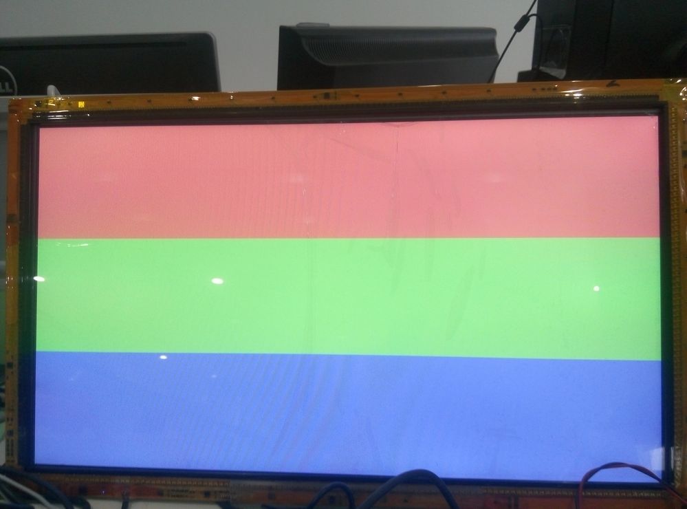

when i modified this:
    #define DISPLAY_WIDTH  1920
    #define DISPLAY_HEIGHT  1080
    #define DISPLAY_BPP    32
    #define DISPLAY_IF_BPP  24  // RGB24 interface
    #define DISPLAY_HSYNC_START 80
    #define DISPLAY_HSYNC_END  68
    #define DISPLAY_HSYNC_WIDTH 12
    #define DISPLAY_VSYNC_START 15
    #define DISPLAY_VSYNC_END  15
    #define DISPLAY_VSYNC_WIDTH 8
    #define DISPLAY_PIX_CLOCK  139526400  //(DISPLAY_HSYNC_START + DISPLAY_HSYNC_END + DISPLAY_HSYNC_WIDTH + DISPLAY_WIDTH) *
(DISPLAY_VSYNC_START + DISPLAY_VSYNC_END + DISPLAY_VSYNC_WIDTH + DISPLAY_HEIGHT) * refresh rate (60Hz)
    #define LVDS_SPLIT_MODE  1  // For dual channel split mode.
#endif
    #define DISPLAY_VSYNC_POLARITY          0
    #define DISPLAY_HSYNC_POLARITY          0
    #define DISPLAY_CLOCK_POLARITY          1
    #define DISPLAY_DATA_POLARITY              0
    #define DISPLAY_DATA_ENABLE_POLARITY        1
    #define IPU_NUM        1  // 1 for IPU1, 2 for IPU2.
    #define DI_NUM          0  // 0 for DI0, 1 for DI1.
    #define LVDS_PORT      1  // 0 for LVDS0, 1 for LVDS1.
    #define DI_CLOCK_EXTERNAL_MODE  //When clock external mode was defined, the DI clock root will be PLL3 PFD1,
                                //without this macro, the DI root clock is IPU internal clock.
and
    bmpReady = 0;
    if (bmpReady == 0) {
        // Fill RGB frame buffer
        // Red
        for (i = 0; i < (DISPLAY_WIDTH * DISPLAY_HEIGHT * (DISPLAY_BPP / 8) / 3); i += (DISPLAY_BPP / 8)) {
#if (DISPLAY_BPP == 16)
            pData[i + 0] = 0x00;
            pData[i + 1] = 0xF8;
#else
and the lcd panel screen display like this:
you can look at this, the color is lighter;
when i change code like this, change "pData[] = 0x FF" to 0x00:
        // Red
#else
            pData[i + 1] = 0x00;
            pData[i + 2] = 0x00;
            pData[i + 3] = 0x00;
#endif
        // Green
        for (; i < (DISPLAY_WIDTH * DISPLAY_HEIGHT * (DISPLAY_BPP / 8) / 3) * 2; i += (DISPLAY_BPP / 8)) {
            pData[i + 0] = 0xE0;
            pData[i + 1] = 0x07;
#else
#endif
        // Blue
        for (; i < DISPLAY_WIDTH * DISPLAY_HEIGHT * (DISPLAY_BPP / 8); i += (DISPLAY_BPP / 8)) {
            pData[i + 0] = 0x1F;
#else
then like this:
it should be black,but it is whilt!
73,523 Views

qiang_li-mpu_se
Yes, from your kernel setting, the DE is high active, so it should be "#define DISPLAY_DATA_ENABLE_POLARITY  1"
For black to white issue, you can change DISPLAY_DATA_POLARITY from 0 to 1 to invert the data line.
I think all these informations should be found from your panel's datasheet.

fulinux
when it should be black it shows white, but when it should be whilt it shows more white, so it can't shows black.
when i change "#define IPU_NUM 1" to 2,it shows white, red and blue looply, why
73,523 Views
qiang_li-mpu_se
Another thing can be tried: invert the clock polarity, change DISPLAY_CLOCK_POLARITY from 1 to 0.
The display shows white, red and blue looply, that means the panel hasn't found valid input signal and show its test pattern.
73,523 Views

qiang_li-mpu_se
From the datasheet, the setting should be followed, no other issues found.
#define DISPLAY_CLOCK_POLARITY   0
73,497 Views

qiang_li-mpu_se
How about your hardware connection?
Do you just used three pair of LVDS data lane? If so, you should set "#define DISPLAY_IF_BPP  24 " to 18.
