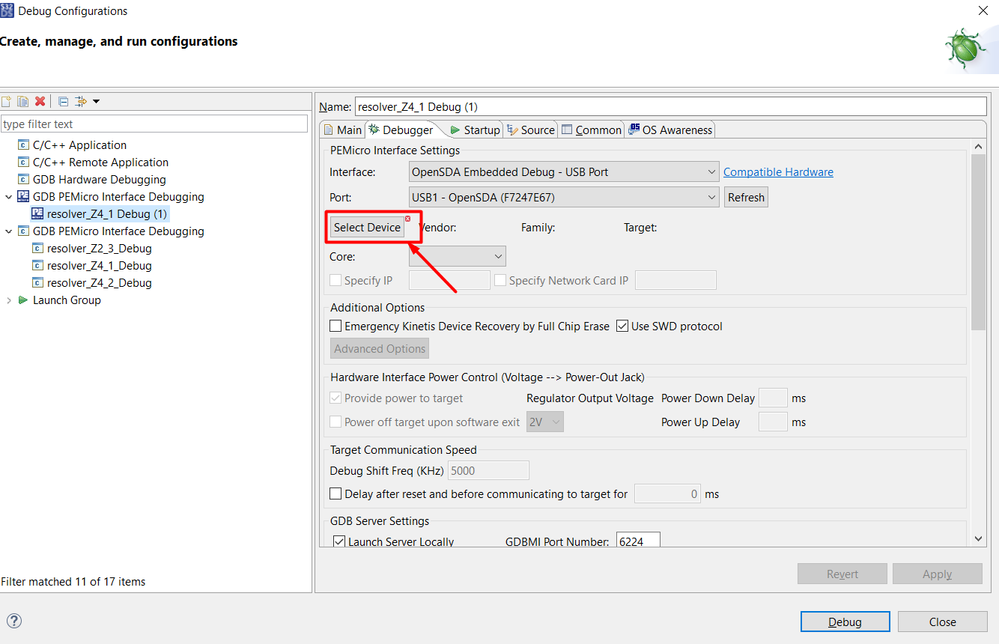

I've been reading how to monitor the variable in S32 DS. Most of people suggest to use the Real-time expression view.
However, I couldn't find my device while I try to debug with it, please see the pic below.
Does it require a special PEMircro cable or the MPC5748G board is simply not supported?

lukaszadrapa
this is copied from Pemicro blog (PEmicro Blog ):
The device itself supports real time access because it has Nexus Class 3+. But you need advanced debugger like from www.lauterbach.com or others which supports this feature.
