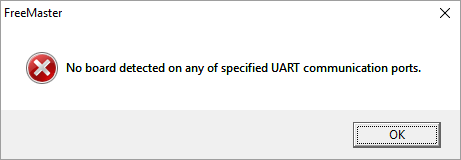

When I connect, the OpenSDA COM port is recognized by Windows just fine. However, on the EVB, the RGB LED is flashing red (contradictory to the QSG which says it should be green), and when I attempt to connect to the board using the FreeMASTER connection wizard all I get is the following prompt:
When I follow through the subsequent dialogs to manually select the COM port and baud rate I get this:

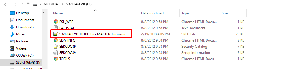

At first, please, copy the "S32K146EVB_OOBE_FreeMASTER_Firmware.srec" (attached) into your S32K146EVB disk that is listed in your PC window.

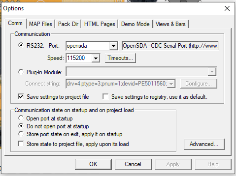

Project -> Options :

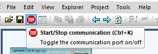

Then after clicking at Start/Stop you will see the jumpstart project
Please, let me know if not helps.
