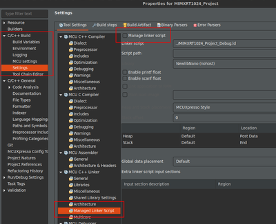

I know this question already is answered, but maybe for "the next guy" who tries to achieve the same. I did the following:
1 - disable managed linker script and move the generated linker script
2 - adjust the linker script to your needs
3 - Adjust the startup code so that stuff gets copied over and VTOR pointer points to new location
1 - disable managed linker script and add some extra variables in the linker script
Before you do anything, make sure you compiled your program so that you can steal the generated working linker scripts sitting in the Debug folder of your project.
Then afterwards, right click on project and open properties.
In the same window, adjust the location of the linker script one folder up so that it no longer sits in Debug folder (which gets nuked when you clean the app, and you would loose your changes).
Optionally, you can also merge the three generated linker scripts into one, for me it doesn't add anything to have the linker script scattered over three files. If you choose to leave them separated, you also need to fix the include paths of the 2 included linker scripts.
Then simply drag the linker script (or if you didn't merge, linker scripts) from Debug folder one folder up (in the root of the project).

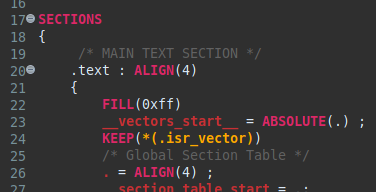

If you open the linker script in its new location, you'll see the part where stuff gets added to .text.
I preferred to have the vector table in its own section. That's not mandatory of course, so edit as your please. I changed it to the following:
    .vector : ALIGN(4)
        __vector_table_flash_start__ = ADDR(.vector) ;
        KEEP(*(.isr_vector))
        __vector_table_flash_end__ = ABSOLUTE(.) ;
        . = ALIGN(4) ;
    } >SRAM_ITC AT>PROGRAM_FLASH
I added this, right after the boot_hdr part.
So what we do here, is we defined some linker variables which will get the address location at the start of the vector tables, and one at the end. Nice would be to also add LOADADDR(.vector) to get the address of the part in ITC memory, but since it's 0x0 anyway I didn't bother.
PS: make sure you properly clean up the KEEP(*(.isr_vector)) from the .text section, since it has no purpose anymore there. The linker won't duplicate the vector, but it's confusing to leave in "dead code".
