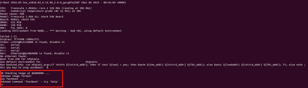

I'm using the imx6ullevk board and L4.14.98_ga, and want to burn image to nand using uuu. I have change some parameters to ahieve uboot for nand & ubi rootfs. And as for imx6ullevk's "nand read", I set that "0x3000000 0x7000000; 0xa0000000 0xa000000". Then I used the "$ sudo ./uuu example_kernel_nand.uuu" to burn the nand. There would get stuck as shown in the attached picture1.
The files I used is as follows:
1) uboot-2018.03-r0.imx → _flash_fw.bin & _flash.bin
2) uTee-6ullevk → _tee
3) fsl-image-mfgtool-initramfs-imx_mfgtools.cpio.gz.u-boot (from L4.14.98 official demo) → _initramfs.cpio.gz.uboot
4) imx6ull-14x14-evk-usb-certi.dtb → _board.dtb
5) fsl-image-machine-test.rootfs.tar.bz2 → _rootfs.tar.bz2
6) zImage-imx6ull-14x14-evk.bin → _Image

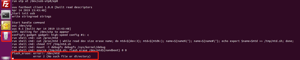

And if I use the files that all of them are from demo, there would also get stuck as shown in the attached picture2.
Hope your help! Thanks !

You can check the uuu download function first with standalone compiled uboot & kernel.
14,792 Views
ida_jiang
Hi Kane,
     I have tried the uboot & kernel. But the error was still that "Unknow command fastboot". The log pictrue is as follows:
14,792 Views
jian_jiang
Besides, I think you should use zImage and imx6ull-14x14-evk-gpmi-weim.dtb instead of zImage-imx6ull-14x14-evk.bin and imx6ull-14x14-evk-usb-certi.dtb.

ida_jiang
Hi Kane,
Actually, I had tried the demo image of 4.9.88 yesterday. But it still got stuck at "flash_erase: error: /dev/mtd0 (No such file or directory)". And I found that when I used the MFGtool, the HID-compliant device would change to be a removable disk G: and the process discontinued.
If I changed the dtb or other files, it would not work.

jian_jiang
Hi Ida,
Strange, what's your PC Windows OS edition? And Chinese or English language? You may need to try more times.
For uuu, you had better enable fastboot configuration manually for fb protocol according to the chapter 10 "Uboot config requirement" in UUU.pdf.
Cause the mx6ull_14x14_evk_nand_defconfig file in 4.14.98-2.0.0-ga release does not include it.
All the Best
Kane
