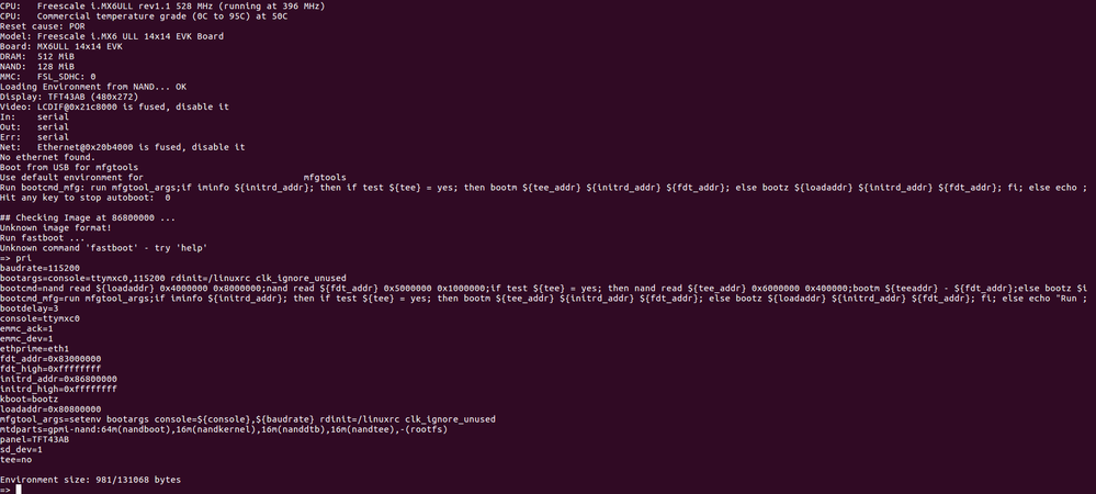

I'm using the imx6ullevk board and L4.14.98_ga, and want to burn image to nand using uuu. I have change some parameters to ahieve uboot for nand & ubi rootfs. And as for imx6ullevk's "nand read", I set that "0x3000000 0x7000000; 0xa0000000 0xa000000". Then I used the "$ sudo ./uuu example_kernel_nand.uuu" to burn the nand. There would get stuck as shown in the attached picture1.
The files I used is as follows:
1) uboot-2018.03-r0.imx → _flash_fw.bin & _flash.bin
2) uTee-6ullevk → _tee
3) fsl-image-mfgtool-initramfs-imx_mfgtools.cpio.gz.u-boot (from L4.14.98 official demo) → _initramfs.cpio.gz.uboot
4) imx6ull-14x14-evk-usb-certi.dtb → _board.dtb
5) fsl-image-machine-test.rootfs.tar.bz2 → _rootfs.tar.bz2
6) zImage-imx6ull-14x14-evk.bin → _Image

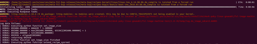

And if I use the files that all of them are from demo, there would also get stuck as shown in the attached picture2.
Hope your help! Thanks !

     I tried to patch with these files and to bitbake again. It got error about do_image_sdcard. Did you get these errors? And it's werid that when I compiled the uboot & kernel standalone, It was successful. But when I did that "bitbake fsl-image-machine-test", it would fail.do_image_sdcard_error.png
How could I deal with it?
Best Regards!
Ida

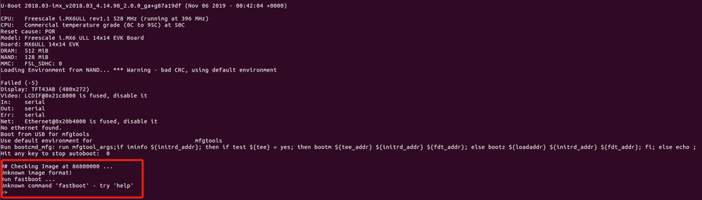

     I have tried the uboot & kernel. But the error was still that "Unknow command fastboot". The log pictrue is as follows:

For uuu, you had better enable fastboot configuration manually for fb protocol according to the chapter 10 "Uboot config requirement" in UUU.pdf.
Cause the mx6ull_14x14_evk_nand_defconfig file in 4.14.98-2.0.0-ga release does not include it.
