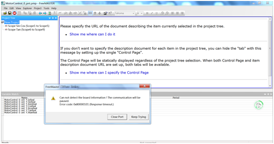

Hi,everyone,

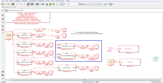

   When I try to implement the " MotorControl_0_pnt.mdl ", the FreeMaster will error that "can't detect the board information"(AS shown below).But I do a little bit modify to the model,  when I remove the part circled by blue, the freemaster and 5744p could communincation correctly. When I add it, the Freemaster won't work properly.
    My matlab version is 2016a, and S32DS version is 2017.R1,Freemaster version is 2.0

Hello [email protected]‌,
I think your problem is related with this one https://community.nxp.com/thread/513398  so please start using our latest release or try some suggestions from that topic.
Hope this helps,
Marius

13226508
Hi,Marius,
   I did it as you said, but the problem remained unsolved.Do you have any other suggestions?
