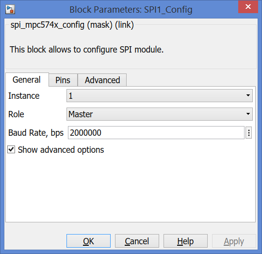

MBDT Toolbox - DSPI Configuration appears to sometimes forget to de-assert CS after DSPI Master Transfer is complete on SPI Config 1.
MPC5744P Using NXP Dev board and associated Motor GD board.. a SPI (0) is configured for GD3000 communication (which isn't used after initial configuration), and an additional SPI (1) on which the problem appears, is configured to talk to a Shaft Speed sensor (Infineon TLE5012B). The CS gets asserted (low) in the code (DSPI_UpdateCS), but relies on CS being de-asserted at the end of the Master transfer (DSPI_MasterTransfer).

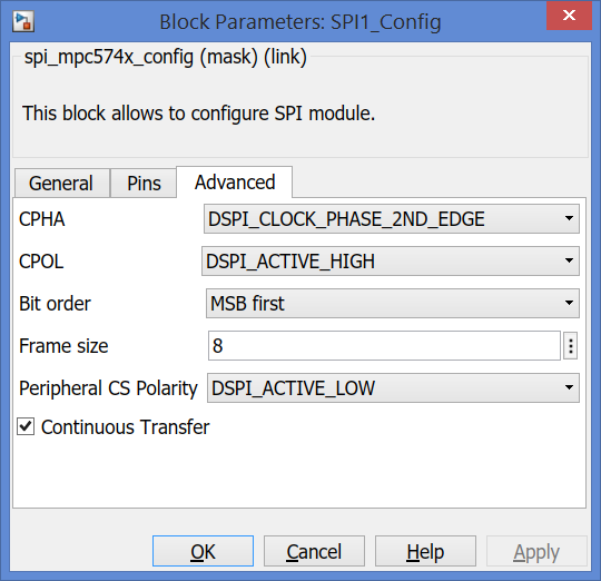

I have run the configuration at 1Mbps or 2Mbps, with same effect. Regular (1ms periodic) short burst reads from the TLE operate correctly, but show a failed CS de-assertion at approx 413ms periods that persist for approx 15ms (while 15 other reads are attempted). Configuration of SPI 1 is set for 'continuous mode', as TLE5012B uses CS edge to 'strobe' information capture, and MBDT cannot otherwise control CS line to NOT be rescinded between bytes of message.

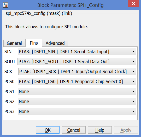

Only 1 CS is configured on both SPI Config 1 and SPI Config 0.

I may need to correct my previous statement regards 500Kbd, as I was changing many other things in the build along with this experiment... so no longer confident the answer was right.
I have this morning being trying a number of different baud rate configurations for SPI1 to try and track the problem down... whilst changing NOTHING else., and keeping the LSA clearly targetted at this issue.
I am unsure of the SPI clock variability or baud rate selection steps (the NXP MBDToolbox doesn't restrict), so doing baud rate selection blind... to see if there is a critical breakpoint.
