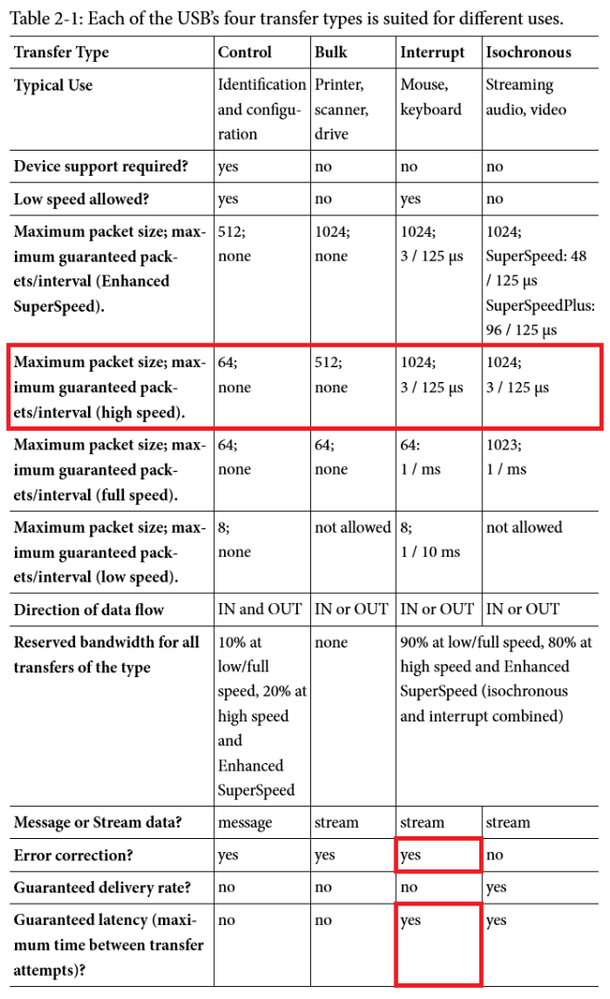

USB to RS232 adapter ICs like the FTDI parts have been one of the most helpful "band-aid" ICs of the modern era.  Thanks to baud rates in the hundreds-of-kBPs they are still and will remain to be very useful.  That said, there are many advantages in utilizing USB without converting such as higher data-rates and error-checking with the downside being extra complexity in design.
The advantage we have today is that many processors with USB transceivers also have the USB physical layer or "PHY" for USB 2.0 full-speed (FS) and sometimes high-speed (HS) built in which reduces IC count.  USB 3.x PHYs generally bump you up to a much higher level of processor which makes it much less practical.  You can also assume that said processor manufacturer also has a USB compliant software stack available as well, though some are documented and supported better than others.  The cherry on top is that some, such as NXP have a comprehensive catalog of functional code examples to help you hit the ground running.  There seem to be a myriad of USB configurations to choose from, but for this discussion, the focus is on simple half-duplex data communications at theoretical maximum rates of up to ~24MBps WITH ERROR DETECTION!
Before I forget, add to your to-do list to buy Jan Axelson's book "USB Complete: The Developer's Guide".  If you might ever have to touch USB in your development life, you will want THAT book within reach.  With that reference out of the way, there are four USB transfer types:  control, bulk, interrupt and isochronous.  Control is primarily for USB devices to initiate connection with a host and isochronous does not guarantee delivery of all data.  Bulk and interrupt will guarantee data delivery, or at least identify in your code that a data transfer error occurred, but I lean toward interrupt transfers as they have guaranteed latency where bulk has to yield the right-of-way to the other three types.  Also, interrupt transfers have a higher theoretical max data rate compared to bulk for both USB 2.0 HS and USB 3.x.
The following is table 2-1 in Jan Axelson's "USB Complete: The Developer's Guide" 5th Edition:
To make things as simple as possible, assuming you will be connecting the device to a Windows or Linux host, you will want to pick a device class that won't require custom drivers.   Trying to shorten this long story, of all the USB device classes out there, all of the above led me to the human interface device (HID) class which inherently uses interrupt transfers.  The two most common HID devices out there are mice and keyboards which are just a fraction of the types of devices (usage pages) and functions for each of those devices (usages) that are defined within the HID class.  For the case of wanting bidirectional data communications for generic purposes HID is still an option as an undefined or vendor specific usage page that plays nice with built-in drivers.
