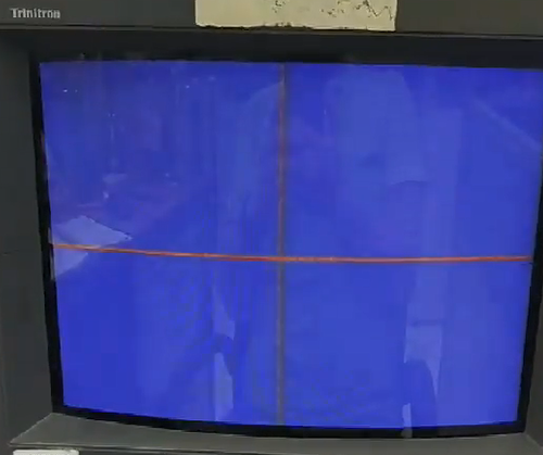

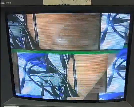

But when I use CSI function to get video data from tw9900 connecting with an analog camera, cvbs out can't show stable video on the monitor as below.

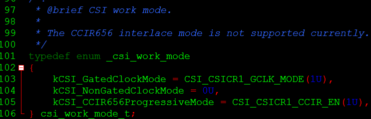

I also check CSI example code from SDK, it mentions below.
CSI work mode: The CCIR656 interlace mode is not supported currently.:smileycry:

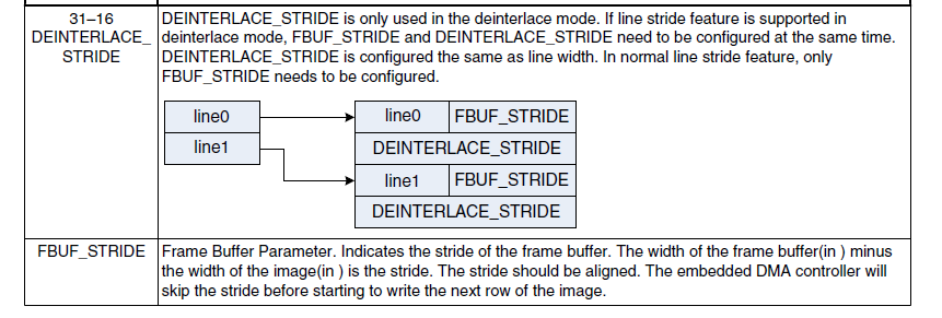

in general one can check description in Reference Manual of
CSI_CSICR18 bit BIT_DEINTERLACE_EN, setting stride
DEINTERLACE_STRIDE register CSI_CSIFBUF_PARA, and can look at
driver sorces in linux/drivers/media/platform/mxc/subdev/mx6s_capture.c

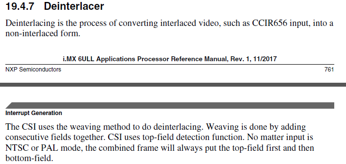

It's mention of deinterlacing function in the specification as below.
So I think just need setting some registers. But I totally have not idea how to do it.

I find out some confusing registers setting as below. But I can't get more information about this register.
Where can I get more information about register setting?

I try to set some bits as below. But it still doesn't work.
BTW, TW9900 uses 27MHz external crystal. Originally EVB uses OV5640 and it use24MHz.
Do you have any idea how solve this issue?
1. CSI_CSICR1
bit27 => 1
2. CSI_CSIFBBUF_PARA
bit 31-16 : (720*2) / 8
bit 15-0 :  (720*2) / 8
3.CSI_CSICR18
bit2 : 1
