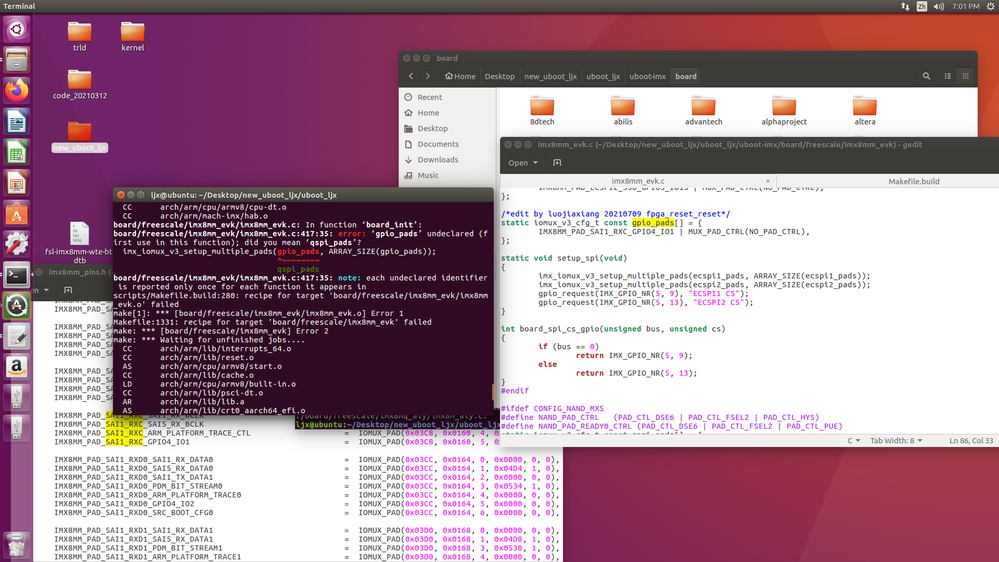

I edited the file (/uboot-imx/board/freescale/imx8mm_evk/imx8mm_evk.c ) and compiled the image.While I was compiling the image ,the error above appeared .What should I do for this?
Thanks.

To modify a GPIO you need to configure in the uboot.dts and you should undo the changes in the imx8mm_evk.c
