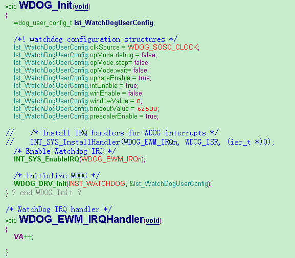

hello:
   Here is my code.
   I enabled the interrupt in the initialization, the watchdog does not refresh the value within 2 seconds will reset, why not enter the watchdog interrupt it? thank you all!

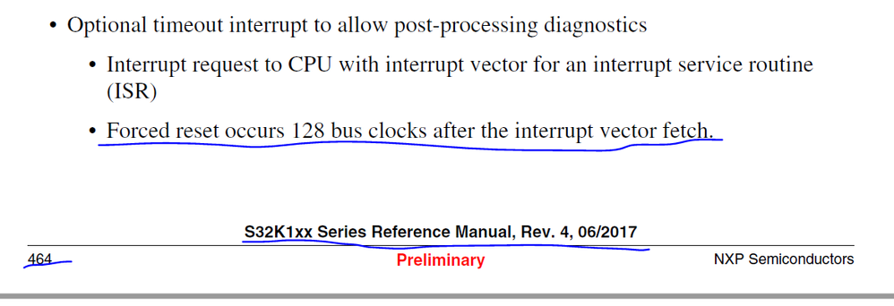

danielmartynek
How do you know it doesn't enter the ISR?
The reset is delayed only by 128 bus clock cycles after the vector is fetched.
Instead of incrementing the VA variable, toggle a GPIO pin.
There is SDK watchdog_interrupt example code, so you can refer to that.
8,810 Views
海斌蔡
hi,Daniel
I set a breakpoint inside the ISR, the program did not enter the breakpoint directly reset. I debug you said the SDK example, I also set a breakpoint in that example ISR, the program is not into the breakpoint reset directly.
The reset is delayed only by 128 bus clock cycles after the vector is fetched.How to understand this?

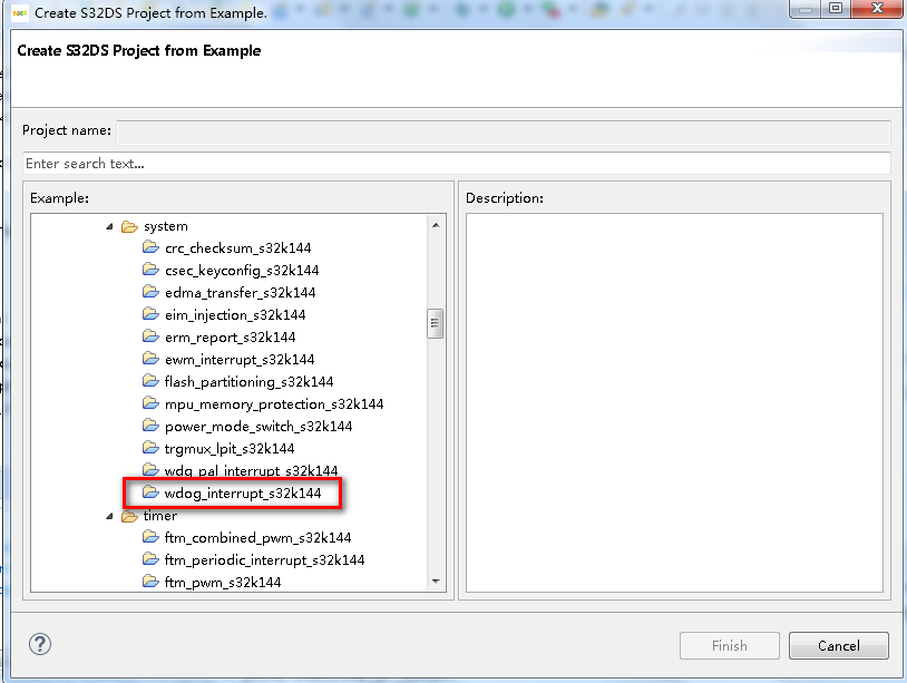

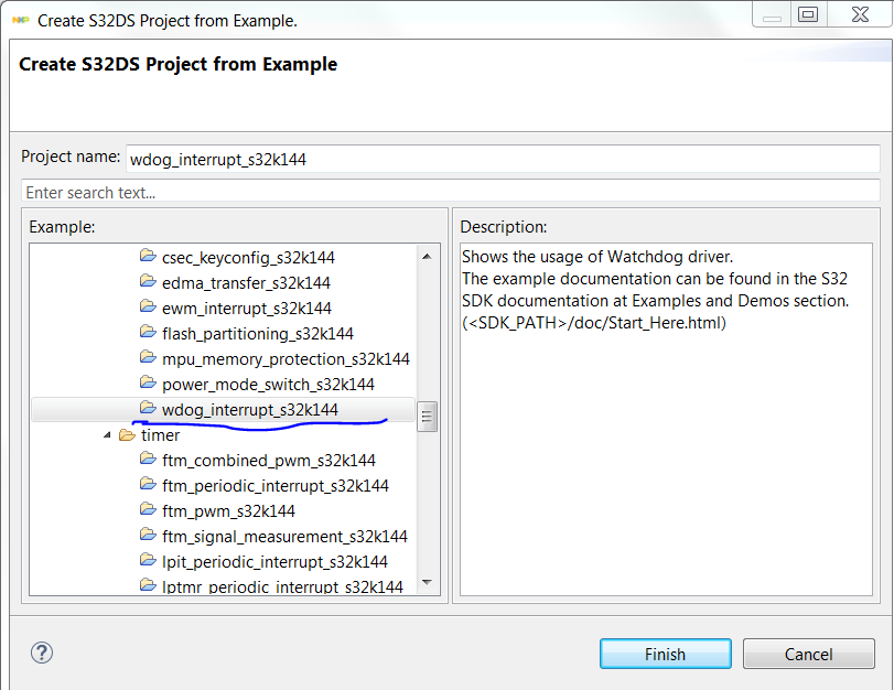

frankzhao1
Hi, Cai,
You can refer to the wdog_interrupt_s32k144 example code provided by S32 Design Studio for ARM v2.0.
I think this demo has a bit of problem but does not affect your reference.
8,811 Views
海斌蔡
Hi,Zhao
I know you say this example, the same example can not enter the WDOG ISR, wdg_pal_interrupt_s32k144 can not enter the same.2018-01-18_114824.png
wdog_interrupt_s32k144 This official example, you can debug into WDOG ISR?
Cai

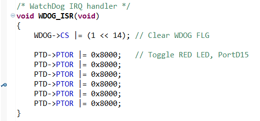

danielmartynek
I modified the WDOG_ISR of the SDK example to simply toggle the RED LED.
/* WatchDog IRQ handler */
void WDOG_ISR(void)
 WDOG->CS |= (1 << 14); // Clear WDOG FLG
 PTD->PTOR |= 0x8000;   // Toggle RED LED, PortD15
I can see it enters the interrupt on the PortD15 pin.
If I place a breakpoint as shown below, I can’t see it stops at the breakpoint, because the reset comes too fast (in 128 bus clock cycles).
Nevertheless, checking the PortD15 pin, I can see it really stops at the breakpoint.
8,811 Views
