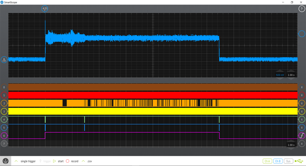

Our HW team decided to use the TI Audio Codec TLV320AIC3107 on one of the boards (utilizing EDM1-IMX6PLUS module from TechNexion) mainly because of the Class D amplifier. I tried to use the  /sound/soc/codecs/tlv320aic3x.c  codec and the /sound/soc/fsl/imx-tlv320aic3x.c machine driver. In the DTS file, the codec was configured to be compatible with tlv320aic3007 (3007 and 3107 are similar and the functionality I need is covered by the 3007 driver). All power supplies are connected directly to the power sources and we are using a gpio pin to drive the reset pin (gpio6 3)
The first issue was that the following message was shown during boot:
tlv320aic3x-codec 2-0018: Failed to init class D: -5
Attaching an oscilloscope to the i2c lines and the reset pin showed that the reset was always set to 0 during boot up. I found out that in the “probe” function, the reset pin was only configured to output but its value was never set. So I made the following two modifications to release the RESET in the probe function and to activate it on power down:

Finally sound was played out of the speaker. The picture below is a snapshot of the oscilloscope screen. The signals are:
-    The Analog line is the audio output
-    Digital 4 is i2c clock
-    Digital 5 is i2c data
-    Digital 6 is the reset pin
