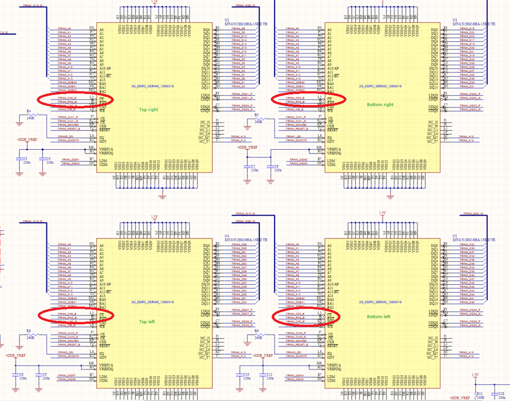

peteramond
Contributor V
Dear #Oliver Chen
Many thanks for your quick response.
1) Do we have any way to check the bad pcb layout ? How can we confirm this with hardware level. By measuring DRAM clock frequencies using oscilloscope?

3) We have used 4 RAMS and each has 4Gbit. You can get the data sheet from here >> http://www.alliancememory.com/pdf/ddr3/Alliance%20Memory_DDR3_4G_AS4C256M16D3A-12BCN_A%20die_Commerc...http://www.alliancememory.com/pdf/ddr3/Alliance%20Memory_DDR3_4G_AS4C256M16D3A-12BCN_A%20die_Commerc... <<
Here is the Schematic for DDR Memory part. (Please look at the red highlighted parts). Here we have used only one chip select DRAM CS0_B for every 4 RAM. That is why I have selected chip select as 1. Any mismatch with this ?
For layout design we used T topology. Please give your idea on this.

11,238 Views
oliver_chen
Hi peteramond‌,
1) Regarding hardware layout, please follow NXP hardware design rules. If you want any documents about PCB layout guideline, please look in NXP website or contact related hardware engineers.
2) As you said, customer's board use T-topology. Do you mean star-topology? NXP recommend customer to use fly-by topology.
Alien‌,
Can you help to review customer's board design?
B.R
Oliver
11,238 Views
peteramond
Contributor V
Hi #Oliver Chen
"From the device table, it has a 2GB DDR3 RAM with 64bit bus width and ONLY 1 chip select. It is very strange. Can you confirm it?"
Can you comment on this ? I have used only one chip select DRAM CS0_B for every 4 RAM (For the RAM schematic in previous message). That is why I have selected chip select as 1. Any mismatch with this ?
Peter.

Hi #Oliver Chen
Many thanks and now it is working.
  1. Could you please tell me how can I get full details on this ADDR, DCD address and MR1 value in DDR Calibration for each RAM. Does those things has mentioned in data sheets ?
  2. As well as the RAM USED IN SABRE SD >> MT41K128M16JT-125:K . And the clock frequency is 800MHz But when we put DDR Frequency as 800MHz in DDR calibration the test will fail. And the other thing is Start Frequency and end frequency. Cant we put start frequency as 750MHz and 800MHz ? It only work for up to 528MHz, Why is that ?

Dear All,
#igorpadykov
#Lisa Hughes,
#Oliver Chen
  1. From where can I find i.MAX6 Quad DDR3 Register Programming Aid ? Can we use the same i.MX 6UL DDR Register Programming Aid for this >> https://community.nxp.com/servlet/JiveServlet/download/329899-3-378909/I.MX6UL_DDR3_Script_Aid_V0.02... << ?
  2. If I'm going to use i.MAX 6UL Programming Aid I think I should change the Register Configuration table according to the RAM in Sabre SDB.
I Edited the Register Configuration as follows >>
But NXP DDR stress tool shows following error message.
Could you please tell me the problem with this error message ? Data sheet for Micron RAM used in Sabre SD >> http://www.micron.com/~/media/documents/products/data-sheet/dram/ddr3/2gb_1_35v_ddr3l.pdf
Please advice on this.
