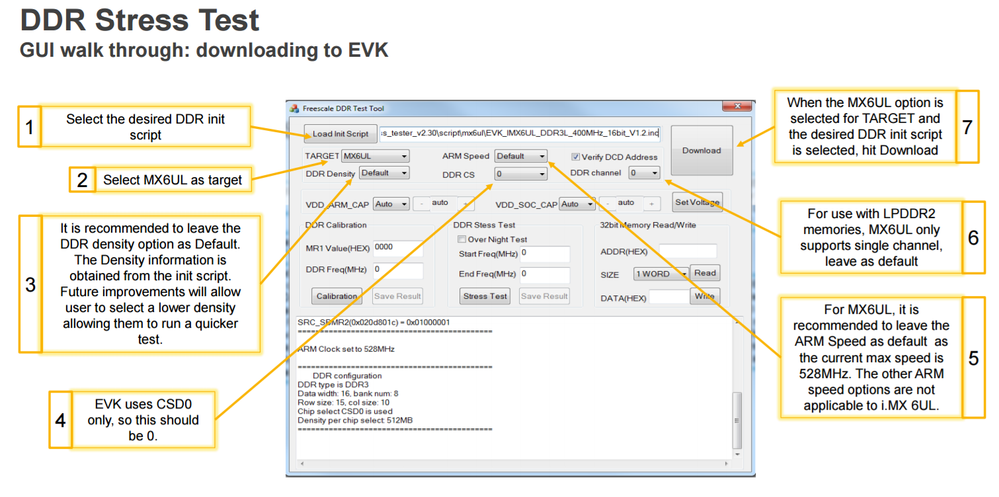

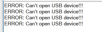

Dear All,
#Oliver Chen
I'm trying to do stress test and RAM calibration for imx6q sbre sdb development board using  i.MAX6 DDR Stress test tool V2.60 >> https://community.nxp.com/docs/DOC-105652 <<
When I go through the above link I couldn't understand how should I approach for this as I'm new to this test. So could you please provide me well detailed document for this.
>> Option 1 GUI based:
Run the GUI executable and connect your board to the host PC via USB
  • Archive file: ddr_stress_tester_vX.xx.zip
  • The tool will first need to run a DDR initialization script for the specified i.MX SoC (refer to Load Init Script in the GUI tool).  Example initialization scripts based on NXP's development boards can be found in this zip file under the script folder.  Note, these scripts may need to be modified for your custom board and memory. " <<
  1. What is GUI executable ?
  2. When I connect SABRE SDB to PC what is the port should I use ? USB OTG or Serial to USB ?
  3. On which hardware should I run GUI executable ? On Sabre SD or host PC ?
  4. Should I run DDR tester.exe on host pc or sabre sdb ?
I must be thankful to you if you will kindly reply me soon.
Peter.

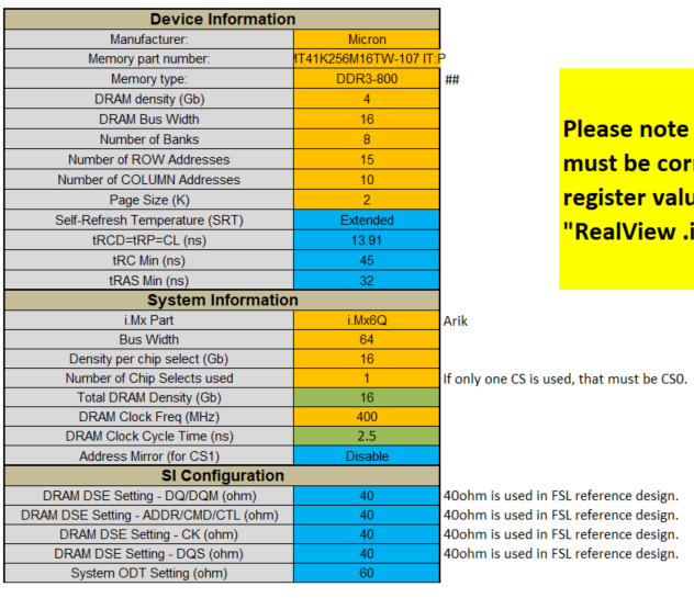

This is a custom hardware design with;
Processor - iMAX6Q - MCIMX6Q6AVT10AC
RAM - 933MHz Micron DDR3L - MT41K256M16TW-107 IT:P
1) Here is the configuration for the script. Can you check and tell me the configurations are correct or not ?
2) Don't you have different script generator for DDR3L type memories (Low Power RAM) ?
3) In memory type I don't have to select DDR3L-933 option. What should I select ?
4) In DRAM clock frequency I don't have to select any option for 933MHz. What should I select ?
5) Under SI configuration section what should I select for
DRAM DSE Setting - DQ/DQM (ohm)
DRAM DSE Setting - ADDR/CMD/CTL (ohm)
....etc.
Can you give me an idea on this SI configuration parameters. Under which conditions of the memory should we change those values and how ?
Waiting for a detailed explanation for this.
Regards & Thanks,
Peter.

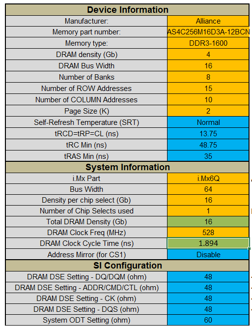

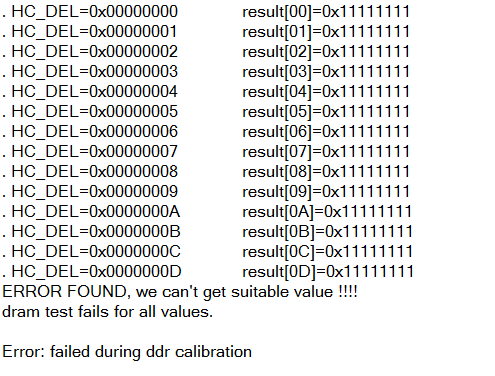

Dear #Oliver Chen # igorpadykov
I'm using ddr_stress_tester_v2.60  software for memory calibration of Alliance AS4C256M16D3A-12BCN RAM included i.MAX6 Quad processor based custom hardware design.
This is the script changes for Alliance RAM
But after loading this script when I run the DDR calibration it shows following message.
What is the reason for this issue ? Is it the problem of new hard ware design ?
I must be thankful to you if you will kindly reply me as soon as possible.
Peter.
8,614 次查看
oliver_chen
Hi peteramond‌,
From the log, it tells us hardware board can not pass write-leveling calibration. It may be caused by bad PCB layout or incorrect DDR script setting.
From the device table, it has a 2GB DDR3 RAM with 64bit bus width and ONLY 1 chip select. It is very strange. Can you confirm it?
B.R
Oliver

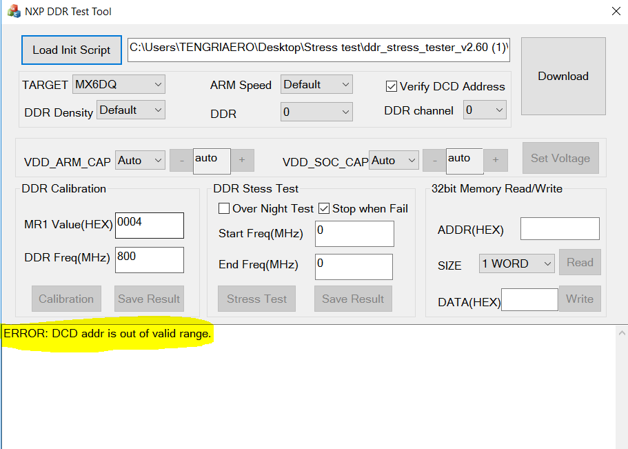

The tool would check the address in your script is valid or invalid if 'Verify DCD Address' is selected in the GUI menu. You can remove the selection to access any address you want.
B.R
Oliver
8,614 次查看
peteramond
Contributor V
Dear #Oliver Chen
Could solve the problem by commenting the following line in scrip >>
//setmem /16 0x020bc000 = 0x30
I got another issue when run the Memory Read/Write
It stuck on highlighted line.
Please advice on this.
Peter.
8,614 次查看
oliver_chen
Hi peteramond‌,
For i.MX6DQ, please use 0x10000000 as DDR base address.

  1. Could you please tell me how can I get full details on this ADDR, DCD address and MR1 value in DDR Calibration for each RAM. Does those things has mentioned in data sheets ?
  2. As well as the RAM USED IN SABRE SD >> MT41K128M16JT-125:K . And the clock frequency is 800MHz But when we put DDR Frequency as 800MHz in DDR calibration the test will fail. And the other thing is Start Frequency and end frequency. Cant we put start frequency as 750MHz and 800MHz ? It only work for up to 528MHz, Why is that ?
Regards and Thanks,
Peter.
8,614 次查看
oliver_chen
Hi peteramond‌,
1.  MR1  is the final value you used for DDR chip Mode Register MR1 when exiting from DDR write-leveling calibration operation. You can read DDR datasheet about MR1 definition. DCD address validation is just for DDR related address. If you want to write any address in script, just ignore the option. There is no problem. Don't be confused by it. DDR address range is described in i.MX6 RM memory map chapter, please read it.
2. DDR tool is an expert tool. I suggest you'd better read technical docs about DDR spec and i.MX MMDC controller chapter in RM. About your question, DDR data is triggered by both clock edge: rising edge and falling edge. When we see 800MHz noted in DDR datasheet, it means 800/2=400MHz DDR clock. For i.MX6DQ, the max DDR3 frequency is 533MHz. Don't try 750MHz/800MHz frequency, it doesn't work.
B.R
Oliver

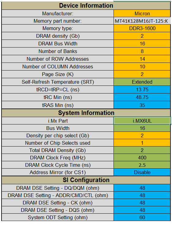

  1. From where can I find i.MAX6 Quad DDR3 Register Programming Aid ? Can we use the same i.MX 6UL DDR Register Programming Aid for this >> https://community.nxp.com/servlet/JiveServlet/download/329899-3-378909/I.MX6UL_DDR3_Script_Aid_V0.02... << ?
  2. If I'm going to use i.MAX 6UL Programming Aid I think I should change the Register Configuration table according to the RAM in Sabre SDB.
I Edited the Register Configuration as follows >>
But NXP DDR stress tool shows following error message.
Could you please tell me the problem with this error message ? Data sheet for Micron RAM used in Sabre SD >> http://www.micron.com/~/media/documents/products/data-sheet/dram/ddr3/2gb_1_35v_ddr3l.pdf
Peter.

I did following steps >>
But when I click "Download" it shows >>
My board is imax6 quad sabre SDB and image running on SD card is " fsl-image-validation-imx-x11-imx6qdlsolo.sdcard" . As well as I connected the sabre SDB to host pc via USB OTG of sabre sdb and then device manager shows NOTHING in user interface. As well as the loaded init script is "MX6Q_SabreSD_DDR3_1GB_64bit.inc"
Peter.
