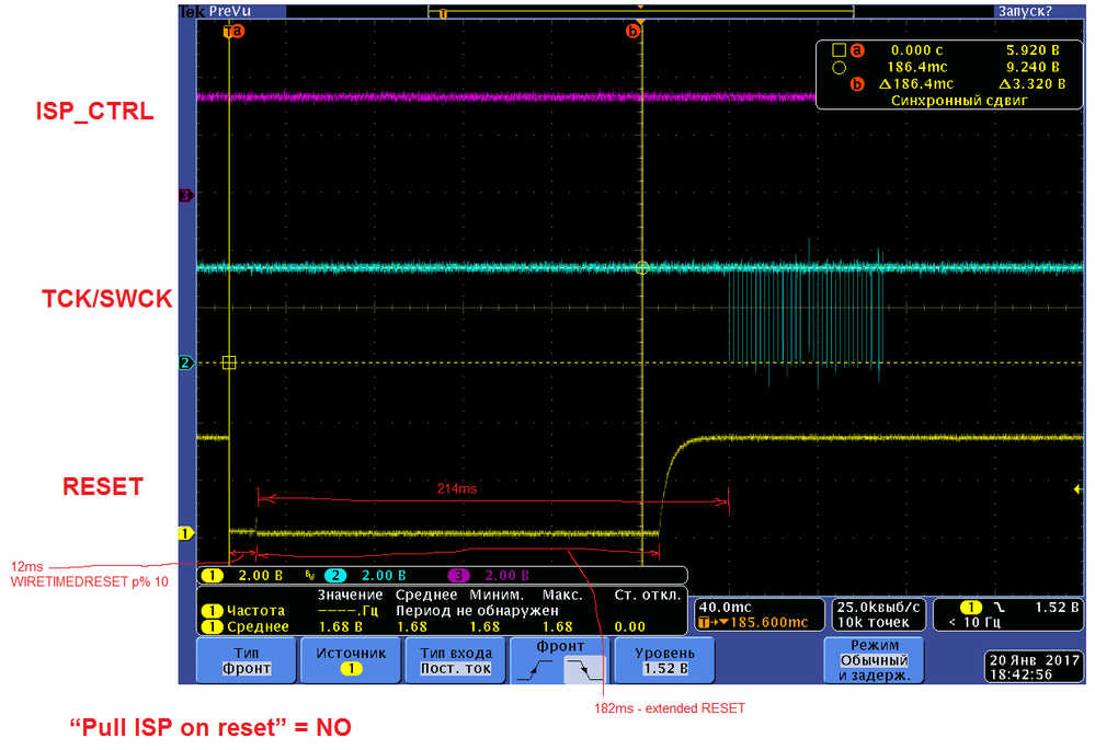

alexandertolchi
Thank You for attention.
With your setting all works (“Attach only = False”, MCU LPC4330 without flash):
Window > Preferences -> LPCXpresso -> Redlink/LinkServer Options -> Pull ISP on reset = NO
No “RESET” and “ISP_CTRL (pin 7)” from IDE, “Connect script” works and forms RESET, program stops on start. Hard RESET absent at all without “Connect script”.

I was set in “Connect script” delay 200ms=2000 and RESET=10ms (but on wire it is 12ms).
Below - oscillograms for “Pull ISP on reset” = NO and next YES:
1(Y) – RESET (pin 10), 2(B) – TCK/SWCK (pin 4), 3(P) – ISP_CTRL (pin 7)

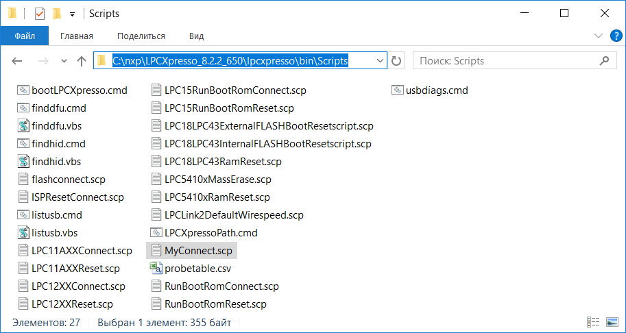

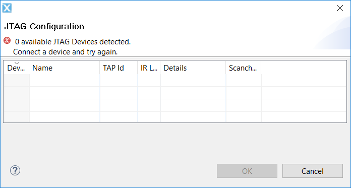

alexandertolchi
OK, bellow - my debug settings and place of "MyConnect.scp" (together with others scripts):
Text of "MyConnect.scp" - the same as above (i changed c% to f%).
JTAG - don't works, messages from “Connect script” in console of RedlinkServer is absent:
Console of RedlinkServer:

If I set “Attach only = True”, than JTAG works:

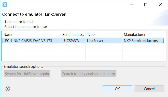

lpcxpresso_supp
Connect/Reset scripts are used with LinkServer emulator connections, typically with LPC-Link2 CMSIS-DAP probes like you're using. Be certain to set the project Debug Configuration Debugger <tab> Emulator selection to LinkServer, or you'll not be allowed to enter a connect or reset script file name.
I understood your supervisor circuit monitors the RESET state and latches the assert for 300 ms. Is this not the case? If not, please explain. If so, the connect script WIRETIMEDRESET command triggers the (assert/release) of the RESET line. So, programming a delay (using the example script above) after this command should provide the delay your supervisor circuit requires. I can assure you the debug utility does not configure the JTAG/SWD wire protocol until the script is finished executing. There are script commands which configure the wire, but you won't be using these.
Thanks and regards,
LPCXpresso Support
