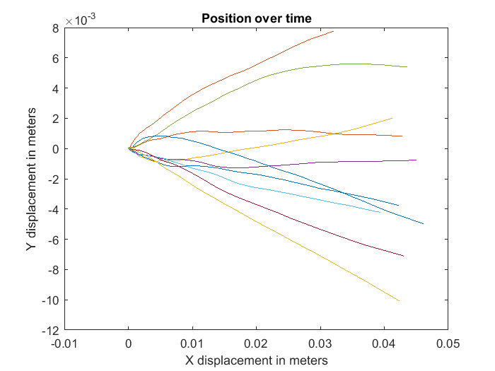

Replace the words "work well" with "work better" and it would be closer to the truth.  We are working on an addition that will allow you to calibrate out post-board mount offset of an accelerometer at 1 temperature.   BUT you still have the effects of random noise in the accelerometer output.  Integrating random noise creates something called "random walk".
In the figure below, I took noise and post-board-mount offset numbers from the MMA8451Q datasheet.  I modelled 20mg offset all in the X axis.  Noise in both X and Y.  After 5 seconds, we have greater than 60cm error in X and about 2mm error in Y.  The X error can be cut down to approximate the Y error by calibrating the accelerometer after the PCB is populated.  There's nothing you can do about the noise terms.

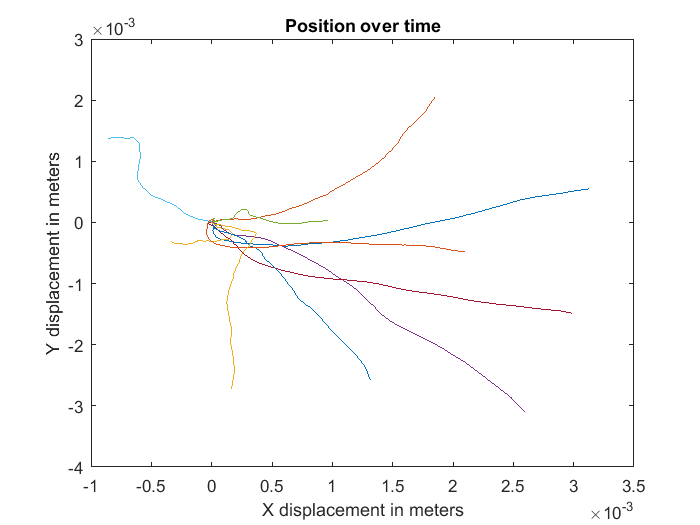

With offset reduced to 1 microG, the curve looks like:
But again, this is using a single-temperature offset correction.  Variations in temperature will cause the terms to increase.

close all;
runs = 10;          %% Number of runs to simulate
g = 9.80665;        %% 1 g = 9.8 meters/sec/sec
N = 126e-6;         %% MMA8451Q Noise = 126 micro-g per root Hz
O = [0.02, 0]*g;    %% MMA8451Q Post-board mount offset = +/- 20mg (modeled as all in X)
fs = 400;           %% sample rate
dt = 1/fs;          %% sample interval
NS = 1000;          %% Number of samples to simulate (5 seconds here)
bw = sqrt(fs);      %% bandwidth
n  = N * g * bw;    %% Noise per sample
v  = 0;           %% velocity in meters/second
cols = 1:2;
for i=1:runs
    v(1,cols)  = [0, 0];          %% 2D velocity in meters/second
    a(1,cols)  = [0, 0];          %% 2D acceleration in meters/second/second
    p(1,cols)  = [0, 0];          %% 2D position, X & Y in meters
    for j = 1:NS
        time(j)=j*dt;
        r1 = 2*rand-1;                  %% A number between -1 and 1
        r2 = 2*rand-1;                  %% A number between -1 and 1
        a(j,cols) = [r1*n, r2*n] + O;   %% measured acceleration noise
        if (j>1)
            %% now do the double integration
            v(j,cols) = v(j-1,cols) + 0.5*dt*(a(j-1,cols)+a(j,cols));
            p(j,cols) = p(j-1,cols) + 0.5*dt*(v(j-1,cols)+v(j,cols));
        end
    end
    plot(p(:,1), p(:,2)); hold on;
    title('Position over time');
    xlabel('X displacement in meters');
    ylabel('Y displacement in meters');
end
