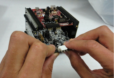

-> In case of using the on-board finger electrodes, press firmly each pair of electrodes (left and right) with the fingertips of your middle and index fingers of each hand while holding the bottom of the board with your thumbs. See this picture:

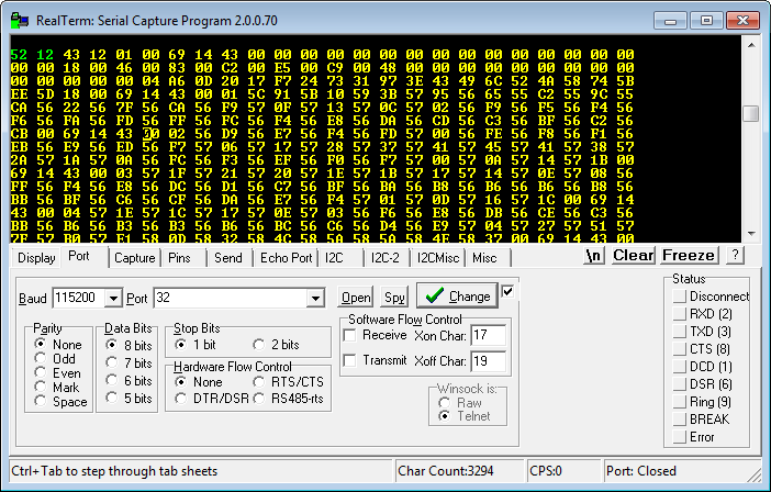

Jorge_Gonzalez
Please read the Appendix B Communication Protocol from application note AN4323.
You can actually control the MED-EKG demo with a terminal without using the Medical GUI, but I think Teraterm cannot print values in hexadecimal format and neither you can send any hexadecimal data. Try installing a Terminal program that can do both: receive/print hexadecimal values and send hexadecimal values.
In the appendix you will see that it is possible to start the EKG measurement by sending 0x52 0x12 (REQUEST packet for ECG_DIAGNOSTIC_MODE_START_MEASUREMENT). Then you can retrieve all the signal information from the INDICATION packets. See below an example:
Regards!
