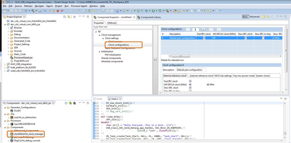

In PE manager, select clockMan1:fsl_clock Manager and look for Clock Settings window (as show below)

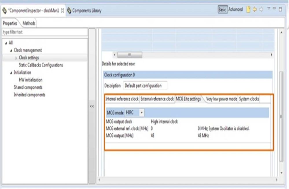

Then, if select MCG Lite Settings tab, current selected mode is LIRC_8M, so, MCGOUTCKL is 4 MHz (below core's minimum value), so, I changed it to HIRC to get a 48 MHz clock signal in MCGOUTCLK.

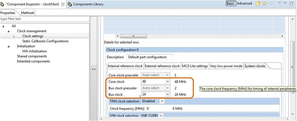

Now, we must set core clock and bus clock to 48 MHz and 24 MHz respectively, Select System clock tab and then set these frequencies as shown below:
I saved these changes, generated the new code, compiled again my project and tested it, I noticed it works correctly. I attach this example so you could test it too.
