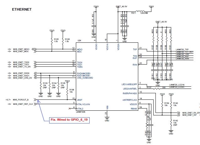

We use SMSC's LAN8720A as RMII PHY on i.MX6solo and currently having problem with
send & receiving packets(Checking at U-boot).

First of all, normally which cause "eth_halt: wait for stop regs" at the beginning?
By looking at code, fec_send function stuck at below two points and return error codes,
while (--timeout) {
   if (!(readl(&fec->eth->x_des_active) & FEC_X_DES_ACTIVE_TDAR))
   break;
if (readw(&fec->tbd_base[fec->tbd_index].status) & FEC_TBD_READY)
   ret = -EINVAL;
Here's our IOMUX configuration and schematics
Needs help for fix this problem step by step.

DuanFugang
It seems phy/mac have no clock.
so, 1. Make sure the iomux config for : MX6_PAD_GPIO_16__ENET_ANATOP_ETHERNET_REF_OUT
      2. From the info from you attached, the clock is from internal anatop PLL, make sure the clock enable. You can measure the GPIO_16 PAD clock.
Andy

jaykim
1. It's my iomux pad value
MX6_PAD_GPIO_16__ENET_ANATOP_ETHERNET_REF_OUT = IOMUX_PAD(0x05E4, 0x0214, 2, 0x080C, 0, 0),
2. Attached are measured 50Mhz clock at GPIO_16.
If it seems no problem, isn't there any other possibilities to cause the problem?
Jay

EgleTeam
Contributor V
Double check on SION bit: you need to "route" 50mhz to ethernet port not only to the PHY chip.
