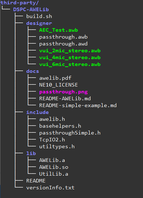

juangutierrez
These are the patches on the latest MM_04.06.04_2112_L5.15.y to support libDSPC on the nxp-afe
Additionally to the patch you should have a third-party directory at the top directory of the nxp-afe
The second patch is for this directory but it is NOT included the binaries. I guess you should got this from your side.
juan

nsoni
Hi juangutierrez,
Thanks for the update. Yes, I am micfil card to read the data. I was able to run afe for some time and it did not show any xrun error. I will go through its AudioStream code and check I can use it for our application. Our application audio plumbing is slightly different where PJSIP (voip client) sends and receives mono channel to loopback card which is sent/receive by DSPC application engine. PJSIP also connects to server and transmit/receive data to/from far end.
I am not aware about libdspc support with afe but I will check internally about it. However, if you have access to libdspc code & lib, you can send me as well. Thanks
