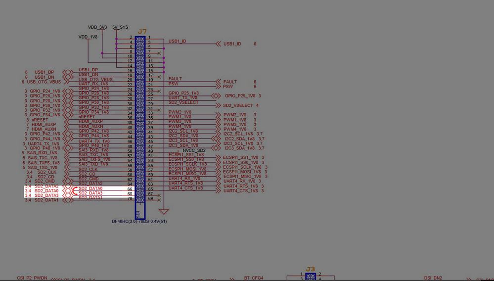

In PICO-PI-IMX8M-MINI, the top carrier/CPU's connector E1 has the pins for DATA0 and DATA3 in this order:
Which is not convenient for custom PCB
I'd like the connector's pin 66
swapped with DATA3, on software level.
I tried doing so by swapping the function names in imx8mm-pinfunc.h

both in kernel and u-boot, relevant dts got recompiled (imx8mm-pico-pi.dtb), flashed/replaced them in the device's OS, yet I got sd card initialization error.
For some reason, changing imx8mm-pinfunc.h didn't alter the pin 66 or pin 68 functions, they stayed as they were, why??
How do I change functions for pin 66 and pin 68 (cpu balls AB23 and V23) respectively? Or is it not possible unless input-output multiplexer (IOMUX) allows it for a particular pad in the alternative function/mux_mode?

Not possible, unless you GPIO bit bang SD pads. If DATA0 would be not involved, then perhaps you could think about bit swapped contents in flash memory. As well, hmm, bit swapped addresses of flash memory. But DATA0 is used to send commands in single pin mode.. Single pin mode still is necessary at least to identify memory chip.
Swapping IOMUX names doesn't make any sense. There's still USDHC controller inside of the chip with dedicated signal names data0-data3. IOMUX allows routing dataN to different pads, but there's no routing means to swap something like data0 with data3.
