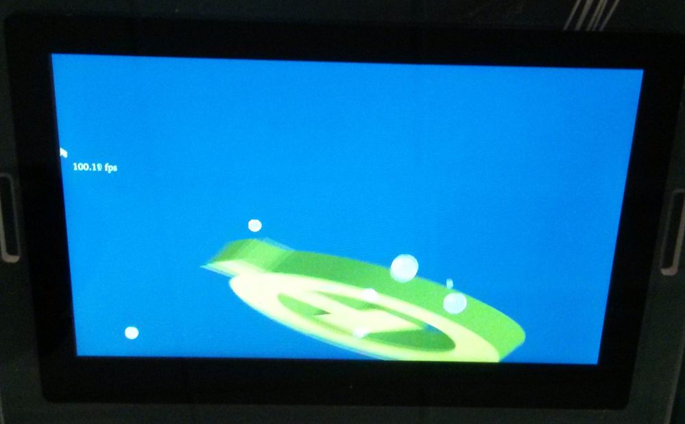

   Verify h/w acceleration support:
1.     Boot the board and verify that the galcore module is installed
              $ cat /proc/devices | grep galcore
              $ ls /dev/galcore
2.     Set up the required Qt environment
              $ export QT_PLUGIN_PATH=/usr/local/Qt-5.1.1/plugins/
       3.     Run the example. You shall see a rotating Qt logo on the display.
              $ cd /
              $ ./hellogl_es
      4.     Run top command and it shows the application running with a very low (0 – 1 %) cpu usage.
              $ top
                PID PPID USER     STAT   VSZ %VSZ CPU       %CPU COMMAND
                2820 2809  root         S         188m 21.5   0              0.7       ./hellogl_es2
