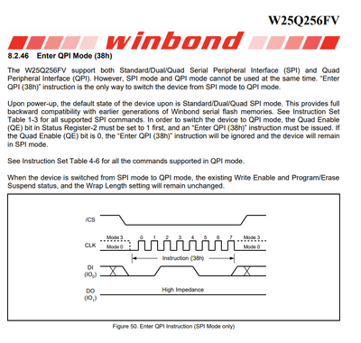

from spec :
we want to read JedecID on QPI style :
but after calling
flexspi_nor_enable_qpi_mode(EXAMPLE_FLEXSPI);
flexspi_nor_get_vendor_id(EXAMPLE_FLEXSPI, &vendorID,kFLEXSPI_PortB1);
we see on the logic analyzer that we transaction was on single spi and seems QPI not working

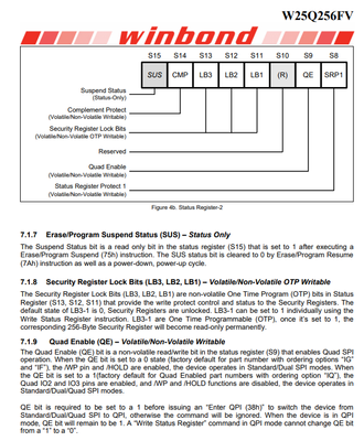

I read status register as 0x7f (01111111) and I cannot modify it
#define FLEXSPI_CONFIG_REG_QUAD_SET_VALUE 0x2U // QUAD = 1

I notice in your LUTs there is missing the Enter QPI mode:
[4 * NOR_CMD_LUT_SEQ_IDX_ENTERQPI] = FLEXSPI_LUT_SEQ(kFLEXSPI_Command_SDR, kFLEXSPI_1PAD, 0x38, kFLEXSPI_Command_STOP, kFLEXSPI_1PAD, 0),
In the flexspi_nor_enable_qpi_mode() please first enable QE bit, it is correct the way you are setting it but it should be the first thing you do on that function so then the command 0x38 can be called to enter QPI.

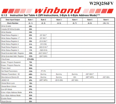

are you sure "kFLEXSPI_Command_STOP" parameter should be entered to LUT for enter QPI mode?
in addition - lets say i will succeed enter QPI mode, the read ID in the LUT mode should be the same?
no parameters needs to be modified?
I need the opcode and the returned data from the device will be spread to 4 lines.

Omar_Anguiano
Yes, I followed the IS25WP064A LUTs to check this. It is important that QE is enabled first before calling this command.
You need to modify the macro kFLEXSPI_4PAD and the command number if the SPI and QPI numbers were different. You can refer to the Instruction Set Table for the QPI commands:
