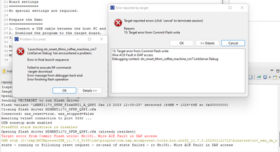

   I am trying to create my custom GUI applications with SLN-TLHMI-IOT and I can't debug and flash my work on the kit via MSD and as guides suggest I don't have a j-link. Is it possible for me to use the MCU-Link Debug tool for flashing and debugging the kit?

Dear Gencay Akyuz,
Sure, this external debugger has i.MX RT1170 as one Supported Device, I just tested to build and run successfully in a SLN-TLHMI-IOT using MCU-Link as debugger.

Hello Ramon,
Thank you for your answer. I am trying to build and debug the coffee machine project, it builds without a problem but when I try to debug it pops up below error. I can see the bootloader log from the terminal but nothing pops up on the display.
0 0 [BOOTLOADER_Task]
*** BOOTLOADER v1.1.0 ***
1 0 [BOOTLOADER_Task] Jumping to main application...
2 0 [BOOTLOADER_Task] [FICA] VERSION 3
3 0 [BOOTLOADER_Task] [FICA] RT Flash Check...
4 0 [BOOTLOADER_Task] [FICA] Found Flash device!
5 0 [BOOTLOADER_Task] [FICA] Checking Image Config Area (ICA) initialization
6 0 [BOOTLOADER_Task] [FICA] Flash ICA already initialized
7 0 [BOOTLOADER_Task] [FICA] Flash ICA initialization complete
8 0 [BOOTLOADER_Task] Launching into application at 0x30100000
Starting CM4 core.
I can't also flash the device via the MSD method. Again there is nothing on the display only the backlight is powered. I tried to create a blinky project by using a built-in RGB LED at the K2 pin but it does not light the LED but I can see a variable changing from the IDE and the bootloader keeps trying to load the program at 0x30100000 address again and again in a loop which I can read from the terminal.
 My main goal is to see the applications that I created from GUI-Guider on SLN-TLHMI-IOT board. I am using an MCU-Link as a debugger, the SDK that I use is SDK_2.x.MIMXRT1170-EVK 2.13 my IDE is v11.7.0.
Can you suggest anything to develop on this board?
