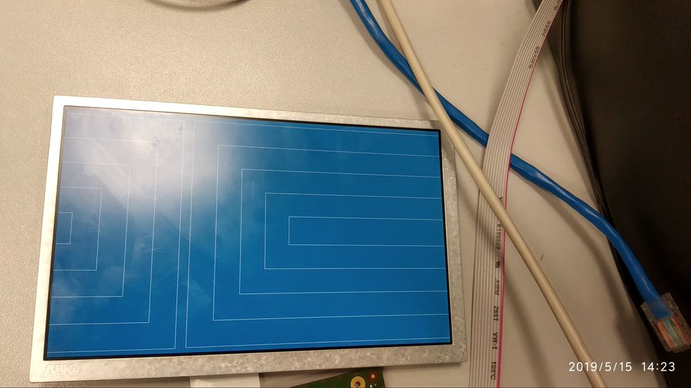

I am using my own design with IMXRT1062. I have connected S70KS1281 hyperram chip to FLEXSPI2 interface. All initialization of hyperram is based on AN12239SW example project.
Hyperram is working, I am able to do read/write test on address range 0x70000000 - 0x71000000 without any errors.  But I have problem with LCD frame buffer located in hyperram address range. If I am displaying static picture on the display, it is working well. But if I draw some points and lines to frame area, Image on the display is shifted to the side. I tried to change frame buffer location from hyperram to OC ram, and inside OC ram, the same source code is working well.
I think this is somehow related to switching between read and write operations on flexspi. I am doing a write operations inside main loop. And LCD driver is doing DMA read operations on backgroud.
My function for drawing pixels in main loop is looking like this:
#define LCD_FRAME 0x70800000
void Point(uint16_t color, uint16_t x, uint16_t y)
 uint32_t addr = LCD_FRAME + (2 * x) + (y * 800 * 2);
 *(uint16_t*)addr = color;
And I have this result on display:
Then I modified draw function like this:
 while (!FLEXSPI_GetBusIdleStatus(FLEXSPI2))
And it solved the problem:
But I think this is not good solution. I think DMA controller should take care about this conflicts automatically...

Hui_Ma
First of all, sorry for the later reply.
It looks ARM Core and DMA arbitrate FlexSPI2 memory resource at same time.
From memory performance benchmark, SDRAM/Hyper RAM/Hyper Flash/Octal Flash nearly has the similar performance.
So, using hyper ram as LCD frame buffer should be ok.
It need to balance ARM core and DMA access hyper ram time slot.
Customer also could change NIC-301 SIM-M7 register to set ARM core and DMA access priority.
Wish it helps.
Mike

pjanco
thanks for answer.
Dafault priority settings after reset is (higher number is higher priority):
LCD 1
PXP 2
CSI 4
Cortex-M7 4
DMA 3
I change LCD priority from 1 to 5 and it solve the problem. Or decreasing Cortex-M7 form 4 to 0 also solve the problem.
But why is default priority of LCD lowest of them?
And why is the default setting funcional with SDRAM but not with Hyperram?
I want to use LCD and also CSI in my project. What priority settings do you reccomend? Higher for LCD or higher for CSI?
And I also enabled RECOVER_ON_UNDERFLOW configuration bit in LCDIF_CTRL1 register.
If this bit is disabled, problem with LCD priority make permanent shift of the picture on display.
With this bit enabled, picture on display is corrected in the next frame.
Peter.

Hui_Ma
Hi Peter,
The NIC-301 default master priority setting is just for reference.
Customer can change related master priority level based on real application.
The default LCD with lowest priority, for not every RT1060 application with LCD display.
The default function with SDRAM, not HyperRAM, which is also just for a reference.
If there using both CSI and LCD with HyperRAM interface, we would recommend to set CSI with lower priority than LCD to access Hyperram memory.
The reason is we tested hyperram write speed is higher than read operation with cache disabled.
The RECOVER_ON_UNDERFLOW bit enabled in LCDIF_CTRL1 register will load LCD frame buffer data again when underflow issue happened. That will recover LCD display if Hyperram bandwidth is arbitrated by LCD and ARM core.
Thanks for the attention.
Mike

pjanco
original values are:
READADDROPT = 0, WMOPT1 = 0, WMENA = 1, WMENB = 0,
There is memory image started at 0x402a400:
30 30 FF FF FF FF FF FF F7 01 08 20 38 00 00 00 00 00 00 00 50 08 00 00 F0 5A F0 5A 01 00 00 00
20 00 00 80 20 00 01 80 20 00 02 80 20 00 03 80 00 00 00 00 00 00 00 00 00 00 00 00 00 00 00 00
00 00 00 00 00 00 00 00 00 00 00 00 00 00 00 00 00 00 00 00 00 00 00 00 00 00 00 00 00 00 00 00
00 40 00 00 00 00 00 00 00 00 00 00 00 00 00 00 04 1C 02 00 63 00 00 00 63 00 00 00 63 00 00 00
00 01 00 00 00 00 00 00 00 00 00 00 00 00 00 00 0C 0C 00 0D 04 00 00 00 00 00 00 00 00 00 00 00
79 00 00 00 00 01 00 00 02 00 00 00 00 00 00 00 00 00 00 00 00 00 00 00 00 00 00 00 00 00 00 00
03 00 00 00 00 0E 00 00 2B 09 00 00 00 00 00 00 00 00 00 00 00 00 00 00 00 00 00 00 00 00 00 00
0D 81 0D 81 00 00 00 00 23 8A 60 4E 18 11 0C D9 68 E1 37 C0 3D 41 78 8F C7 92 7A 78 A5 FE 11 AA
FF 63 CE F8 5D 86 6E 73 8F 7D B0 AC 88 0B 18 F5 61 8F 1C 72 8F F9 B9 9D 51 FF BD 23 09 CC 7E 6B
EE 72 C1 30 04 2F 31 C5 CC 98 FE C1 60 B9 DD 12 89 09 12 82 98 49 0A E2 57 68 48 A7 21 A0 21 A4
07 31 B7 E6 27 C8 E3 FA C4 0D 8E 5F 20 F0 CE C6 4D 8F 6B 8E 36 08 51 A5 69 85 77 D1 1D E2 7F 9C
00 00 00 00 00 00 00 00 00 00 00 00 00 00 00 00 00 00 00 00 00 00 00 00 00 00 00 00 00 00 00 00‍‍‍‍‍‍‍‍‍‍‍‍‍‍‍‍‍‍‍
I change configuration to this:
READADDROPT = 1, WMOPT1 = 0, WMENA = 1, WMENB = 1,
But problem still persist.
Didi you think that this have a solution?
I need to decide if I should continue with Hyperram or change my design to SDRAM and then use some secondary procesor to expand GPIO pins.
Peter.
