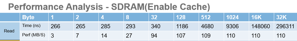

It looks ARM Core and DMA arbitrate FlexSPI2 memory resource at same time.
From memory performance benchmark, SDRAM/Hyper RAM/Hyper Flash/Octal Flash nearly has the similar performance.
So, using hyper ram as LCD frame buffer should be ok.
It need to balance ARM core and DMA access hyper ram time slot.
Customer also could change NIC-301 SIM-M7 register to set ARM core and DMA access priority.
Wish it helps.

Hui_Ma
Hi Peter,
The NIC-301 default master priority setting is just for reference.
Customer can change related master priority level based on real application.
The default LCD with lowest priority, for not every RT1060 application with LCD display.
The default function with SDRAM, not HyperRAM, which is also just for a reference.
If there using both CSI and LCD with HyperRAM interface, we would recommend to set CSI with lower priority than LCD to access Hyperram memory.
The reason is we tested hyperram write speed is higher than read operation with cache disabled.
The RECOVER_ON_UNDERFLOW bit enabled in LCDIF_CTRL1 register will load LCD frame buffer data again when underflow issue happened. That will recover LCD display if Hyperram bandwidth is arbitrated by LCD and ARM core.

Hui_Ma
Hi Peter,
First of all, sorry for the later reply.
What's the FlexSPI Flash operation frequency?
There are some configurations could affect HyperRAM performance:
  • Cache Impact
RT1050/60 support max 32K DCACHE and 32KICACHE, it can improve the performance more after enable cache.
  • Prefetch Buffer Impact
RT1050/60 support 1024KB prefetch buffer, its policy as below:
  1. available to configure buffer to specified master or multiply master share the same buffer.
  2. Automatically prefetch data to buffer till buffer is full.
  3. Try to check if hit prefetched address range , if it is out of range, trigger the new read operation from FlexSPI device, otherwise, if it has been in prefetch buffer, read it from AHB buffer, if not, waiting for prefetching data to buffer.
So it has the different configuration base on application.
  • if each data access is small size and access address is not continuous, suggest set smaller prefetch buffer size.
  • If it is continuous address access, suggest to set big prefetch buffer size.
From our internal HyperRAM test performance, we with below recommendation:
  • Enabling cache to improve Hyper RAM performance more.
Wish it helps.

Hui_Ma
Hi Peter,
From our internal test result, the HyperRAM performance versus SDRAM, which SDRAM read throughput rate (ARM core read) is slower than HyperRAM:
HyperRAM MPU config:
    non-shareable
    Cacheable
    Write back
    Enable Dcache
best regards,
Mike
