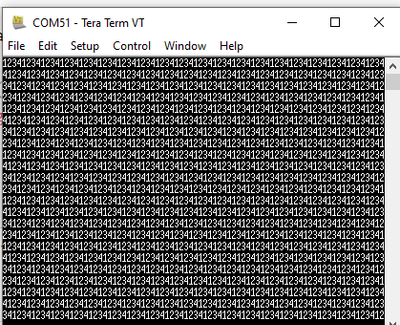

    while (1)
        for(delay_cnt=0; delay_cnt<60000;delay_cnt++);
         LPUART_ReadBlocking(DEMO_LPUART, &ch, 1);
         LPUART_WriteBlocking(DEMO_LPUART, &ch, 1);
Then you will receive the result like this:
Wish it helps you!

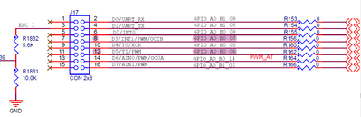

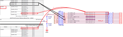

I set the EVK Board Pin Configuration as below.
Configuration:
UART1_TXD = GPIO_AD_BO_06 (Arduino Interface J17 : Pinout 12)
UART1_RXD = GPIO_AD_BO_07 (Arduino Interface J17 : Pinout
I connected these pins with two-sided male jumper.

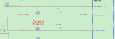

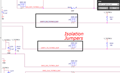

Hi @Lukas_Frank
  If you need physical test, why you add the internal loop back?
1. external TTL-USB tool test, you need to disconnect the on board COM port.
J45, J46, disconnect, then you can connect your external TTL-USB to the J45_2, and J46_2 pin.
Please note, external TX connect to J45_2, external RX connect to J46_2.

Why I am not able to send my datas to Arduino Interface UART1 pins. I listen the target pins for UART1 with oscilloscope. Although I send my datas to UART1 there is no data flow that seen in oscilloscope. Are not Arduino Interface pins physical?
Second:
How can I disconnect J32,J31 COM ports?
Third:
Where are J32,J31 on board? Is there a way to quickly find my targets on board? I have J45,J46.
Answer: Which pin you have connected?
You mentioned :
Configuration:
But your code is using:
Second:
Answer: Not J32,J31, it is J45,J46, I post the wrong picture in the last email, already modify it.
  So you can't use your mentioned J17, that is connected to the LPUART2, but your code is using LPUART1.
So you need to use J45_2, J46_2.
Third:
Answer: you are right, your board is  J45,J46.

I think is it possible to use Arduino Interface for physical test. I am happy for this. I have three questions more:
First:
What are the missing points for LPUART2 correct configuration? Is there tool that configure automatically for IMXRT1024 like Code Genaration Tools like IMX CONFIG TOOLS (i.MX-RT1050). If it is not which points should I focus for the correct configuration?
Second:
You said that "you need to disconnect the on board COM port. disconnect J45, J46". I did not exactly understand it. Is there a specific need for this? Is not it possible to do loopback without TTL-USB?

kerryzhou
Hi @Lukas_Frank
   If you use the directly LPUART SDK project, you need to use  J45,J46, it is LPUART1.
   But if you want to use the J17, you need to modify the code, pinmux, you already modified, then the main code, Lpuart 2 interface, just use the polling code at first.
   Now, please check your board, R153,R154 is connected or not?

I just learned this. Then, I rethought over the whole process. There was not an explenation in Reference Manual about it and I am new in Embedded World as Software Engineer. Thanks for all your patience
I have two more question:
Q1: UART Write and Read operations prints data to terminal screen (serial port configuration) successfully in SDK Pooling Example. But, there is not printing data to terminal screen when I create a project from scratch despite data communication is successfully occur. Why could be my example is not printing to terminal?
Q2: I am not able to make sense one parameter in IOMUXC_SetPinConfig method in the BOARD_InitPins. It is configValue parameter of IOMUXC_SetPinConfig (sixth-one). I see it assigned as 0x10B0U in the SDK Pooling example. Why? What is the meaning of 0x10B0U. Is there a sheet that explain different combination of this parameter for spesific cases or Is that value constant for all cases?
