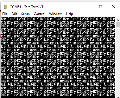

3. to your loop back, you also can write the code like this:
uint8_t txbuff[]   = "1234";
uint8_t rxbuff[20] = {0};
 * Code
void LPUART_Loopback_Mode_Enable(LPUART_Type *base, bool enable)
	if(enable)
		base->CTRL |= LPUART_CTRL_LOOPS_MASK;
		//base->CTRL |= LPUART_CTRL_RSRC_MASK;
	else
		base->CTRL &= ~LPUART_CTRL_LOOPS_MASK;
		base->CTRL &= ~LPUART_CTRL_RSRC_MASK;
 * @brief Main function
int main(void)
    uint8_t ch;
    lpuart_config_t config;
    uint16_t delay_cnt=0;
    BOARD_ConfigMPU();
    BOARD_InitPins();
    BOARD_BootClockRUN();
     * config.baudRate_Bps = 115200U;
     * config.parityMode = kLPUART_ParityDisabled;
     * config.stopBitCount = kLPUART_OneStopBit;
     * config.txFifoWatermark = 0;
     * config.rxFifoWatermark = 0;
     * config.enableTx = false;
     * config.enableRx = false;
    LPUART_GetDefaultConfig(&config);
    config.baudRate_Bps = BOARD_DEBUG_UART_BAUDRATE;
    config.enableTx     = true;
    config.enableRx     = true;
    LPUART_Init(DEMO_LPUART, &config, DEMO_LPUART_CLK_FREQ);
    LPUART_Loopback_Mode_Enable(DEMO_LPUART,true);
    LPUART_WriteBlocking(DEMO_LPUART, txbuff, sizeof(txbuff) - 1);
    while (1)
        for(delay_cnt=0; delay_cnt<60000;delay_cnt++);
         LPUART_ReadBlocking(DEMO_LPUART, &ch, 1);
         LPUART_WriteBlocking(DEMO_LPUART, &ch, 1);
Then you will receive the result like this:
Wish it helps you!
kerry
9,811件の閲覧回数

I just learned this. Then, I rethought over the whole process. There was not an explenation in Reference Manual about it and I am new in Embedded World as Software Engineer. Thanks for all your patience
I have two more question:
Q1: UART Write and Read operations prints data to terminal screen (serial port configuration) successfully in SDK Pooling Example. But, there is not printing data to terminal screen when I create a project from scratch despite data communication is successfully occur. Why could be my example is not printing to terminal?
Q2: I am not able to make sense one parameter in IOMUXC_SetPinConfig method in the BOARD_InitPins. It is configValue parameter of IOMUXC_SetPinConfig (sixth-one). I see it assigned as 0x10B0U in the SDK Pooling example. Why? What is the meaning of 0x10B0U. Is there a sheet that explain different combination of this parameter for spesific cases or Is that value constant for all cases?
