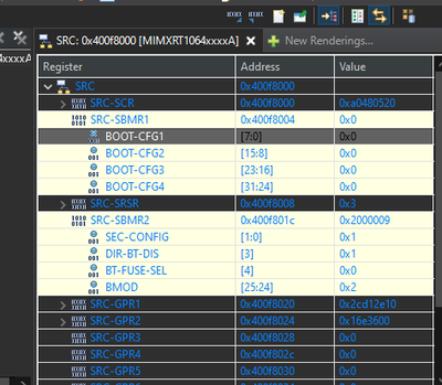

As a bit of an update to add some more info, I've continued on with the following:
  • Changed BOOT_MODE1 to pull up.
  • Changed other pulls on the BOOT_CFG lines.
I now have the following:
  • BOOT_MODE[1:0] = 0b10 (internal boot)
  • BOOT_CFG1 = 0x0
  • BOOT_CFG2 = 0x0
I've verified the above with the debuggeR:
Unfortunately, I'm still getting stuck when debugging in the 0x218390 region... This varies, but it still seems like it's in serial loader mode somehow?
This doesn't 100% make sense to me... what else am I missing?
