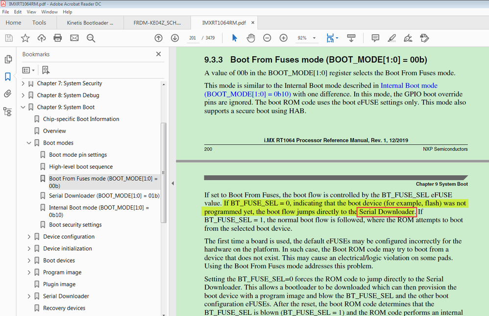

  1. Boot mode select: 10  internal boot.
   If you only select "Boot From Fuses: 00", please check the RM content about this:
   If you didn't burn the fuse, it means your mode still the serial downloader mode.
  This mode will let the customer to download the app code with the UART or HID interface, they can use the mfgtool or the MCUbootUtility tool to download the code, but if they want to boot from the the internal side, they need to modify the fuse, please note, fuse just one time operated area, after it is burned, it can't be modified any mode, so, normally, we use the BOOT_MODE pin to select the mode at first.

Answer: I still think customer's issue is the boot mode issue, the chip still in the serial download mode, not internal boot mode.

  You can try the RAM project, if it works, then download to the flash, if it is not work, you can try to burn the fuse map, let the chip boot from internal side. Check the RM Table 9-4. Boot eFUSE descriptions
Please note, fuse map just one time operation, just can modify 0 to 1, can't be modified back.

Modified the circuit to change the Boot Mode to Internal Boot.
I was able to operate it stand-alone safely.
