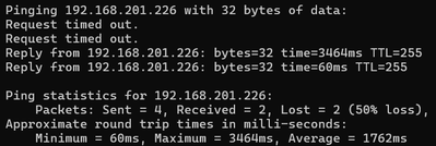

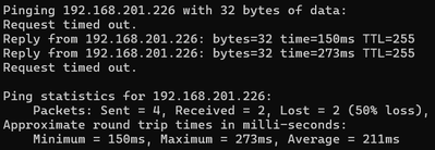

etronic_arg
Hi Daniel,
This is the terminal output:
Starting httpsrv DEMO
[i] Initializing Wi-Fi connection...
STA MAC Address: 20:BA:36:53:86:F9
[i] Successfully initialized Wi-Fi module
Connecting as client to ssid: xxxxxx_2_4G with password xxxxxxxx
[i] Connected to Wi-Fi
ssid: xxxxx_2_4G
[!]passphrase: 1a2b3c4d5e
Now join that network on your device and connect to this IP: 192.168.201.226
HTTP Server example
IPv4 Address : 192.168.201.226
IPv4 Subnet mask : 255.255.255.0
IPv4 Gateway : 192.168.201.1
IPv6 Address0 : -
IPv6 Address1 : -
IPv6 Address2 : -
mDNS hostname : wifi-http
Ready
Every seems to be fine.
After that, I enter 192.168.201.226 in a Chrome browser.
The web page takes about 10 seconds to load and sometimes the browser times out.
In the polling example, the time refreshes every 3-7 seconds.
I'm using a Windows PC on the same network to ping:
I tested the lwip_httpsrv example, and the response was significantly faster.
Pablo

3,862件の閲覧回数
etronic_arg
Thank you for testing it!
I will try it on another router; however, I don’t have speed issues when I use my smartphone on the same network in the same position.
I located the boards right beside the router and it improves a little:

Reply from 192.168.201.226: bytes=32 time=14ms TTL=255
Reply from 192.168.201.226: bytes=32 time=86ms TTL=255
Request timed out.
Reply from 192.168.201.226: bytes=32 time=1114ms TTL=255
Reply from 192.168.201.226: bytes=32 time=20ms TTL=255
Reply from 192.168.201.226: bytes=32 time=104ms TTL=255
Reply from 192.168.201.226: bytes=32 time=114ms TTL=255
Request timed out.
Reply from 192.168.201.226: bytes=32 time=509ms TTL=255
Reply from 192.168.201.226: bytes=32 time=129ms TTL=255
Request timed out.
Reply from 192.168.201.226: bytes=32 time=3341ms TTL=255
Reply from 192.168.201.226: bytes=32 time=2ms TTL=255
Reply from 192.168.201.226: bytes=32 time=17ms TTL=255
Reply from 192.168.201.226: bytes=32 time=45ms TTL=255
Reply from 192.168.201.226: bytes=32 time=131ms TTL=255
Reply from 192.168.201.226: bytes=32 time=108ms TTL=255
Reply from 192.168.201.226: bytes=32 time=216ms TTL=255
Reply from 192.168.201.226: bytes=32 time=89ms TTL=255
Reply from 192.168.201.226: bytes=32 time=227ms TTL=255
Reply from 192.168.201.226: bytes=32 time=111ms TTL=255
Reply from 192.168.201.226: bytes=32 time=124ms TTL=255
Reply from 192.168.201.226: bytes=32 time=122ms TTL=255
Request timed out.
Reply from 192.168.201.226: bytes=32 time=70ms TTL=255
Reply from 192.168.201.226: bytes=32 time=169ms TTL=255
Reply from 192.168.201.226: bytes=32 time=140ms TTL=255
Reply from 192.168.201.226: bytes=32 time=153ms TTL=255
Reply from 192.168.201.226: bytes=32 time=58ms TTL=255
Reply from 192.168.201.226: bytes=32 time=159ms TTL=255
Reply from 192.168.201.226: bytes=32 time=197ms TTL=255
Reply from 192.168.201.226: bytes=32 time=113ms TTL=255
Reply from 192.168.201.226: bytes=32 time=77ms TTL=255
Reply from 192.168.201.226: bytes=32 time=84ms TTL=255
Reply from 192.168.201.226: bytes=32 time=63ms TTL=255
Reply from 192.168.201.226: bytes=32 time=96ms TTL=255
Reply from 192.168.201.226: bytes=32 time=244ms TTL=255
Reply from 192.168.201.226: bytes=32 time=99ms TTL=255
Reply from 192.168.201.226: bytes=32 time=199ms TTL=255
Reply from 192.168.201.226: bytes=32 time=172ms TTL=255
Reply from 192.168.201.226: bytes=32 time=118ms TTL=255
Request timed out.
Ping statistics for 192.168.201.226:
    Packets: Sent = 89, Received = 83, Lost = 6 (6% loss),
Approximate round trip times in milli-seconds:
    Minimum = 2ms, Maximum = 3341ms, Average = 211ms
Just to confirm:
1. Although I am using the UBlox Maya W2 module, the configuration should be WIFI_IW612_BOARD_MURATA_2EL_USD?
2. The firmware used is sduart_nw61x.bin.se.inc, however I found that there is a version V1:
https://github.com/nxp-imx/imx-firmware/tree/lf-6.12.34_2.1.0/nxp/FwImage_IW612_SD
Should it work with the original?
3. Is there a way to configurate the output power?
Thanks.
