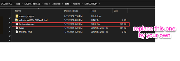

A quick test that you can do is import our flashloader demo from the SDK, and find where the tool replace the  tool's flashloader.srec by yours. I found that the tool places flashloader  screc for the RT1064 in this address : MCUX_Provi_v8\bin\_internal\data\targets\MIMXRT1064
The tool should use the flashloader that you created and then you can take commands as an example.

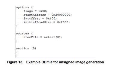

I tried using elftosb on s-records file, accordingly to information in the i.MX MCU Manufacturing User's Guide. See this example from section 4.2:
And guess what, elftosb segfaults with zero indication why. Terrific. By luck I discovered that the identifier "srecFile" must be "elfFile" (even though it's not an elf file) and it finally works.
So....  elftosb silently corrupts your program and also segfaults on simple issues like above. Why after all these years haven't these buggy tools been fixed?

Update: this is exactly the same problem as here https://community.nxp.com/t5/i-MX-RT/elftosb-issue/m-p/994838
elftosb is silently truncating the data section from the program image. It requires s-records file to be used.
