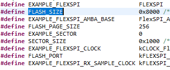

I have changed the flash size definition in the code:
I noticed that when I reach the address 0x100 0000 and above I actually reach address 0x0.

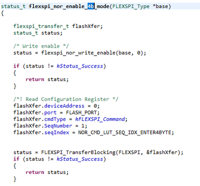

I have add this to LUT:
and with the function:
but its not effective

I supposed you are using 3BYTE address mode, but for the address bigger than 3BYTE(bingger than 0x100 0000), you cannot get the correct data. So i thinks you should use 4BYTE address mode access the space bigger than 0x100 0000.
You can read the flash datasheet to know how to use 4BYTE mode and update the LUT in RT device.

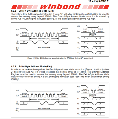

this is from the data sheet:
if i only need to add values to the LUT table, which should I add?

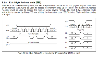

@adi2Intel could you please let us know if changing that 0x18 (24) to 0x20 (32) in the LUT is sufficient to make W25Q256FV flash to work? I suspect the answer is NO because according to 6.1.5 in datasheet, to operate in 4-bytes addressing mode ADP bit in Status Register must be set, but factory default value for it is 0.
Please also pay attention to what you wrote in the LUT, according to the datasheet 0xE9 command is EXIT 4-byte addressing mode, not ENTER.
Let us know, please. Thanks!
