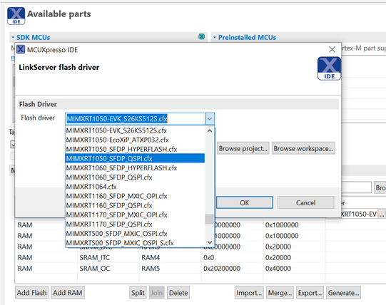

jingpan
Hi @gianpiero_lenta ,
Please try this flash driver.
Here is an previous post for your reference.
https://community.nxp.com/t5/MCUXpresso-IDE/RT1050-evkb-Unable-to-download-and-debug-QSPI-Flash/m-p/...
